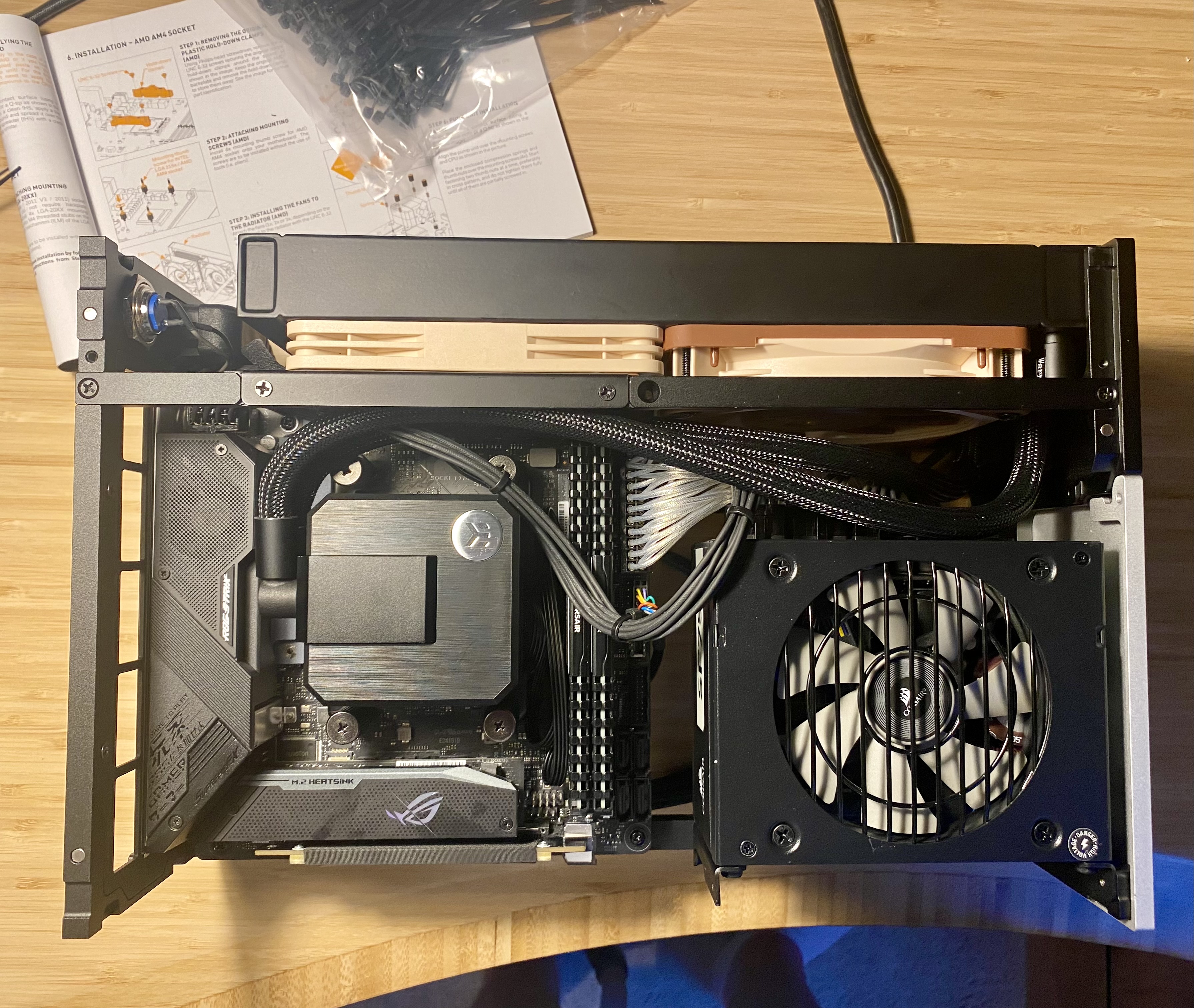

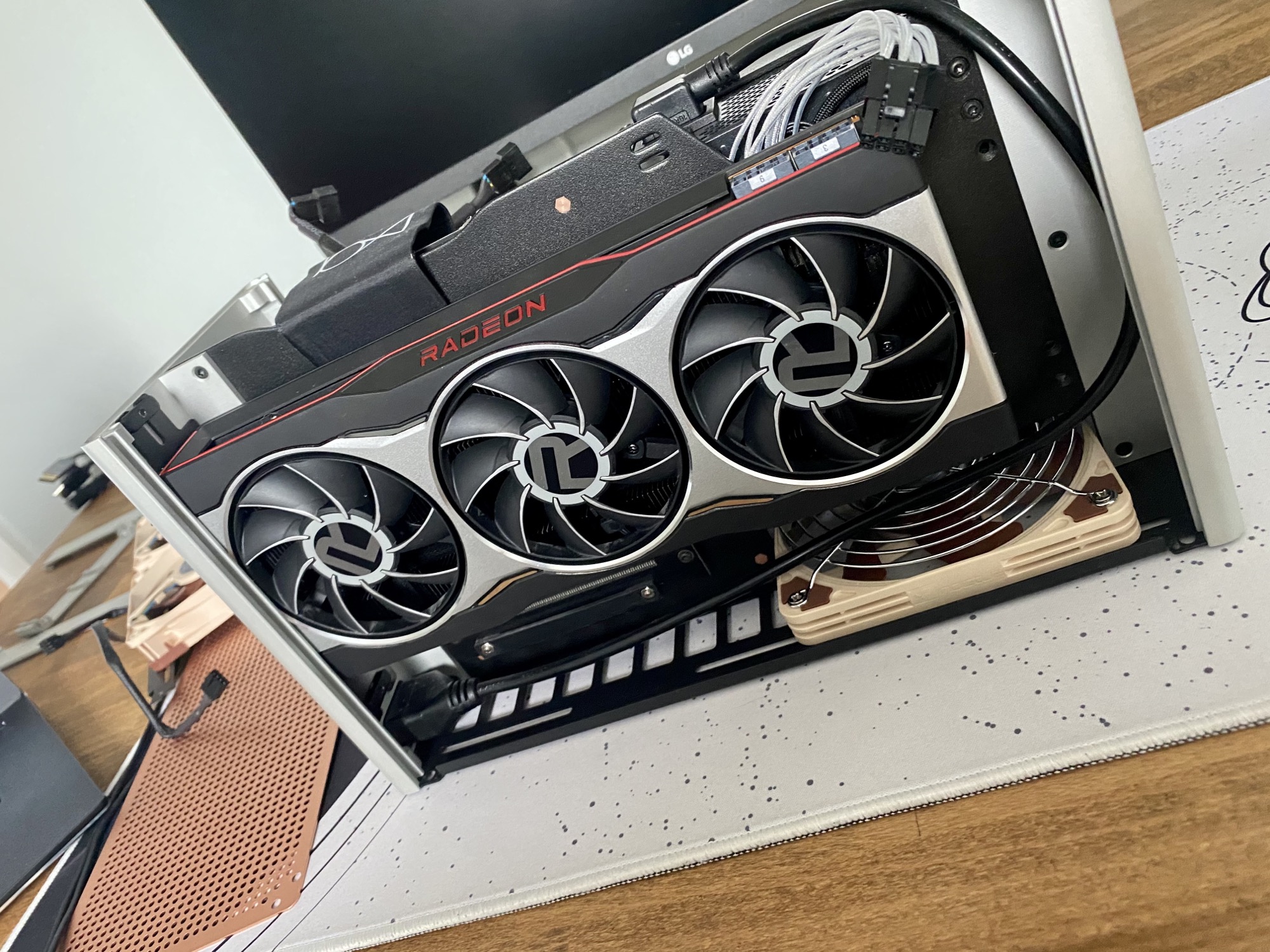

I used the NF-A12x15 in Ghost S1, Ncase M1 and Formd T1 builds - but have since moved to a 4000D mid tower so I can have my PC under my desk. Small form factor PCs don't play nicely under a desk..!
It was a single fan in exhaust in the Ghost S1, two slim fans as side intakes on the Ncase and then a single exhaust slim fan in the Formd T1 build.
And in the Ghost S1:
The Formd T1 build was a bit odd. I had a single slim fan alongside a full size 25mm fan in that build below a 240mm AIO. Slightly odd set up, ended up moving away from it as the AIO helped CPU thermals but impacted GPU thermals so decided to swap back to an air cooled build.
