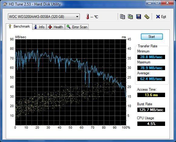

Just ran HDTune, this is the results:
The drive's fine. Transferring between locations on the same physical disk is always going to be slow, the drive only has a single set of read and write heads so it has to keep moving between the source and target locations. The time spent moving the heads really affects the average transfer rate.
