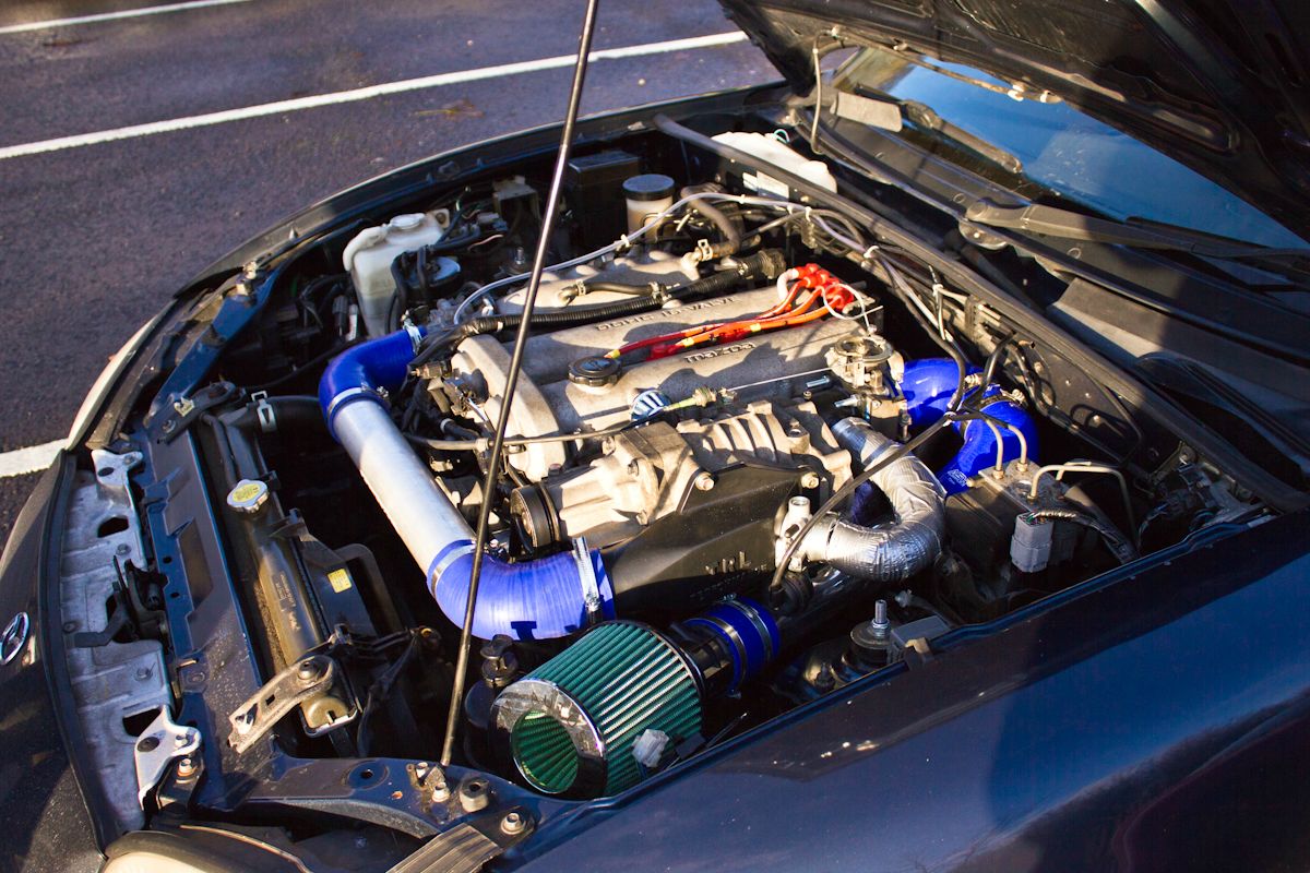

Those of you at the RR will have seen the deterioration of my temporary bypass pipe first hand. Basically, the pressure in there was quite a lot higher than I anticipated and it just blew the pipe apart.
Replaced it with the pipework I ran out of time to make fit:
Went for a drive and it seems all good. First time I've gone through the gears WOT properly from 2nd. Seriously seriously impressed with how quickly it picks up speed. Ridiculously impressive the difference it has made - and thats at 182bhp! When I get to the 200 mark it is going to feel incredible.
