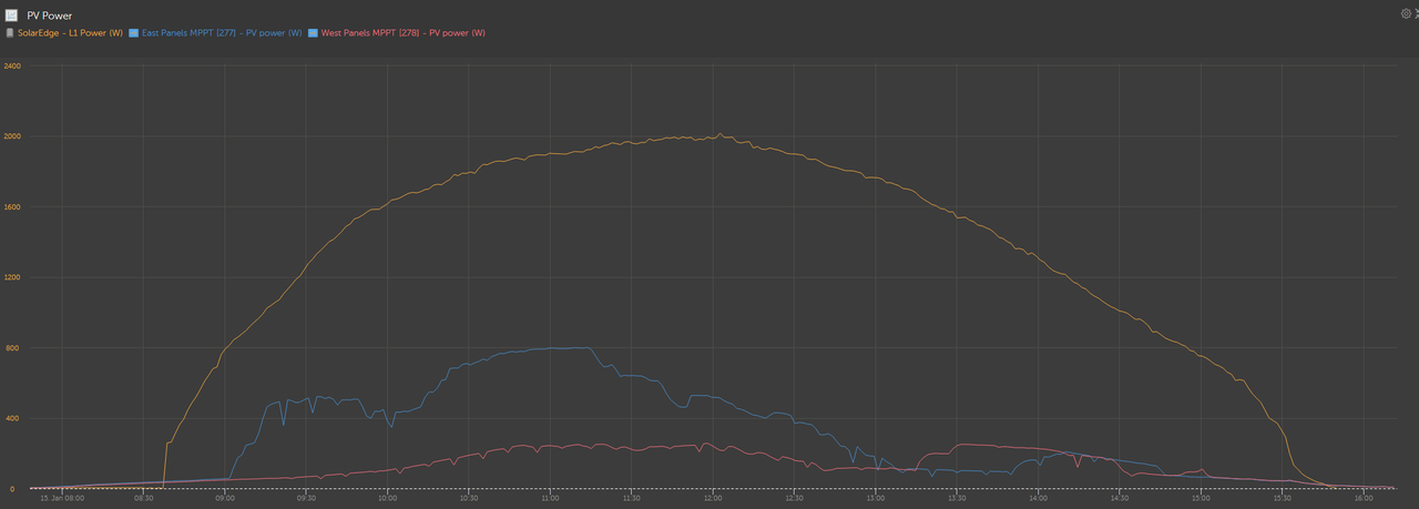

13, not bad. Installed some tigo optimisers this morning on the bar panels (4) and they seem to be already working wonders. The pitch was bringing the rest of the system down.
Ordered another 4 panels to squeeze in. A total of 25.
Happy to be proven wrong if there is a problem with the software this end but seems to stack up with the graphs.
Looking at what others have generated today with south facing systems its perfectly possible, it's going to be one corker of a system come the summer months.
Some systems count battery discharge as PV yield, and we also have the odd person posting from over sea's, hence I was wondering where you was located.
A perfect solar day, and 13.4 kWh, 10.3 of that was from the SE system.
This shows just how bad the low sun and resultant shading affects my garage panels.
South facing is king at this time of the year. My South-east facing 4.8kW array could only make 10.4kWh with a perfect day today as the sun is only just rising when its directly opposite. The bottom string also gets a bit of shade so is about 30% down on the top one. The new 4.62kW of panels on the north-west roof don't get any sun yet, but are generating 1-2kWh per day just due to reflected light. Ironically they are best when it's cloudy at the moment.
I'm hoping for over 50kWh by June with the new setup though.
