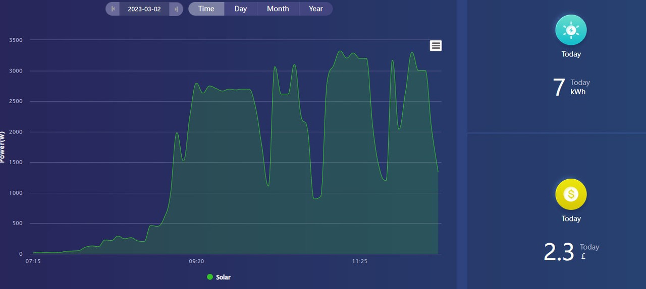

I feel like Solcast predicting 25kWh today was a little over-optimistic but so far, it does seem like we may get better than the 10 or so I've seen lately if this kind of production keeps up.
It's bluish skies with some clouds out at the moment.
Solcast is completely off for today. I'm tracking at around 1/3 of its hourly estimates so far. It predicted 11 kWh for the day. I'm on 1.8 so far.

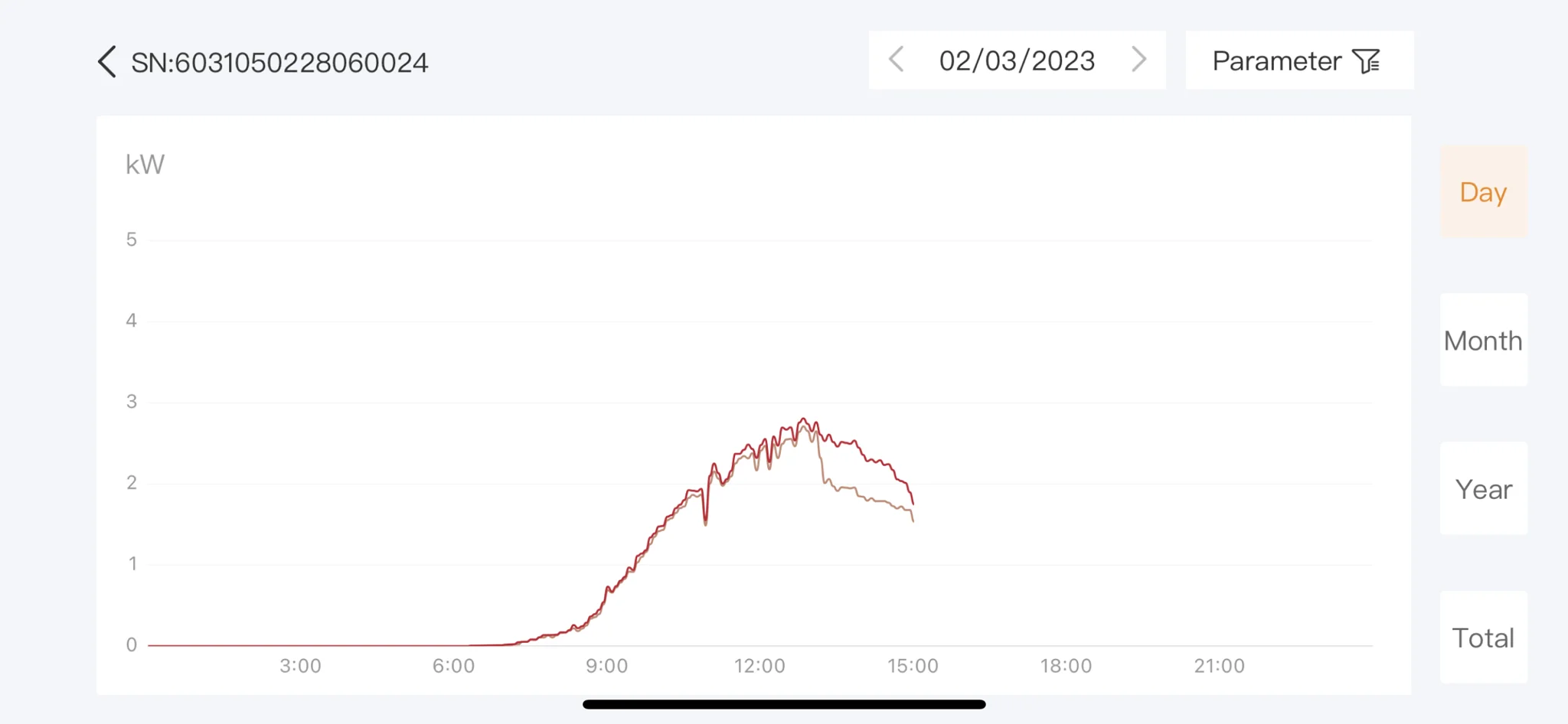

Unfortunately we are still in shading territory, so second string will start to fall off a little soon… there’s a near 600w difference at the moment between the left and right strings
Shoulda gone Solar edge lol.

3pm and the output is dropping off as the shading spreads… down to 3.6kW when it should be making lots with the south west facing.
I believe my peak should be around 2-3pm were it not for the shading issues, as you can see below I peak around 1pm at the moment when string one starts to drop…. but even so it’s already clocked 23.5kwh today. Going to be great in a couple of months!
I believe my peak should be around 2-3pm were it not for the shading issues, as you can see below I peak around 1pm at the moment when string one starts to stop…. but even so it’s already clocked 23.5kwh today. Going to be great in a couple of months!
