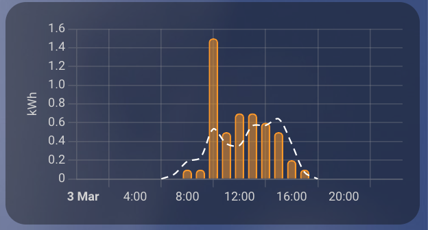

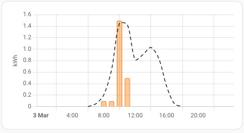

Solcast on its last call has reduced its prediction for today. I don't think thats how forecasts are meant to work.
This morning
Now
