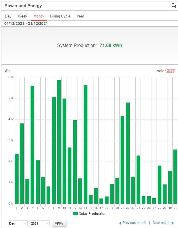

We have a 4kw system installed in December 2015, if I ignore December 2015 then last December was the worst month so far, 71.08kWh produced, January are not much beter . May 2020 was the best month ever with 712.532kWh of production.
The 17th was 0.261kWh, and the 27th was 0.274kWh
