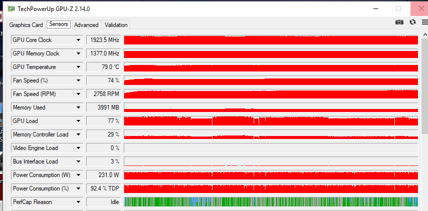

So the below is with default fan profile after only a couple of minutes sat idle in a mission in Hitman 2 (note, this is any game, just using Hitman 2 for an example as it's a GPU intensive game)
Idle is around 50C always needing around 10% fan speed on default
This is my custom fan profile:
Granted, I'm still tinkering around with the fan profile as 60% is too loud imo but I can't go any lower because the equilibrium seems to sit around 85C at 55%.
Finally, here is going back to default profile after running custom, here you can now see the fans struggling to get the temps back down to stop thermal throttline (pink bars on perfcap reason).
