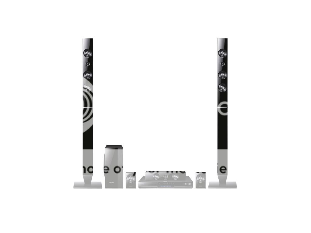

Well after a little mucking about the stereo surround works fine with the TV but is useless with the PS3 so I've decided to move the stereo upstairs to the computer room and purchase this:
It's the Samsung HT-D5530/XEU 3D Blu-ray DVD Home Theatre System. Should be delivered and installed by the end of the month. I'll pop a few pics up when it's all done. I'm looking forward to COD in surround sound along with a few decent films as well. Also I was wondering if anyone could advise whether they know if this product will work with no problems with my television please?

the speakers have now arrived, unfortunately we wont have the time to set these up and enjoy them until the end of the month due to work commitments :(
