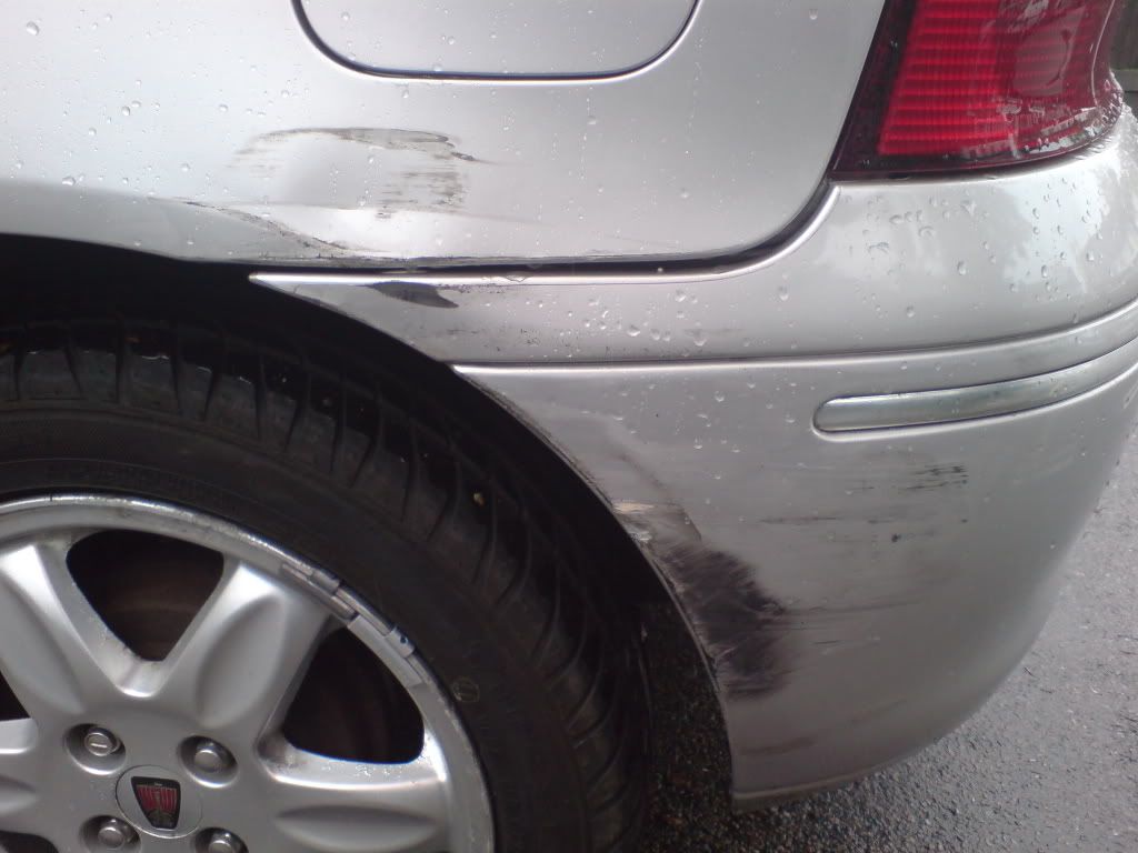

Someone bumped my car

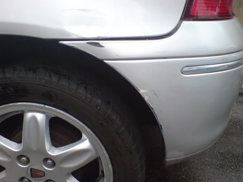

Man i'm lazy... Took some water and a non scratch scourer to it today. Looks like i just need T-Cut or something.
Before:
After:
t-cut is turd, get something like menzerna power gloss for some real correction
Wtf are you serious:confused: This grip this whole 'detailing' thing has on people really gets to me.
You would be best off taking the rest of it off with some thinners, and then polishing it afterwards.

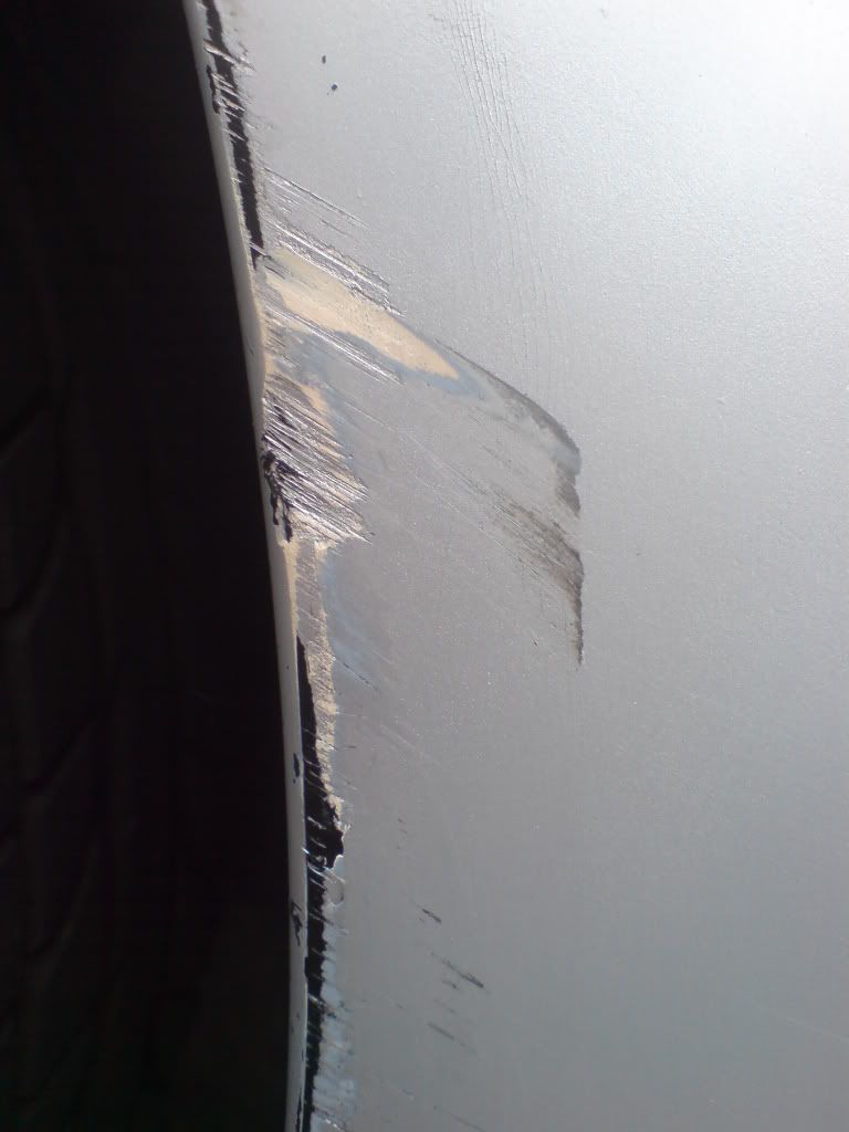

Thanks for the responses - here is a close up.
Thinners - can i use white spirit?
Is that the primer showing? Is the black stuff from the other ***********'s car or my bumper?

I have no idea if 'menzerna' is any good but T-Cut is crap. It may have been useful 20 years ago but not now with metalic paint and clearcoat
I used T-Cut scratch removed after i hit a van rear bumper and scuffed my wing and headlight and it worked a treat, you need to use normal polish after as the scratch remover is mildly abraisive. Looking at the damage i think you've lost some paint.

As mentioned, that will now need painting.
