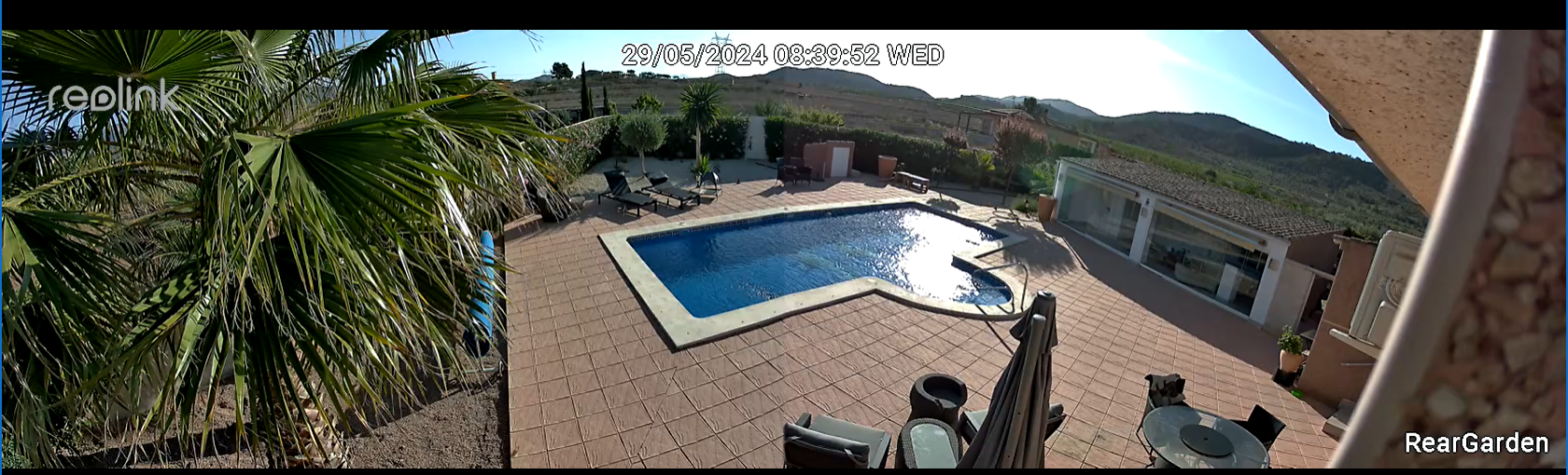

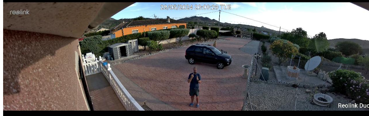

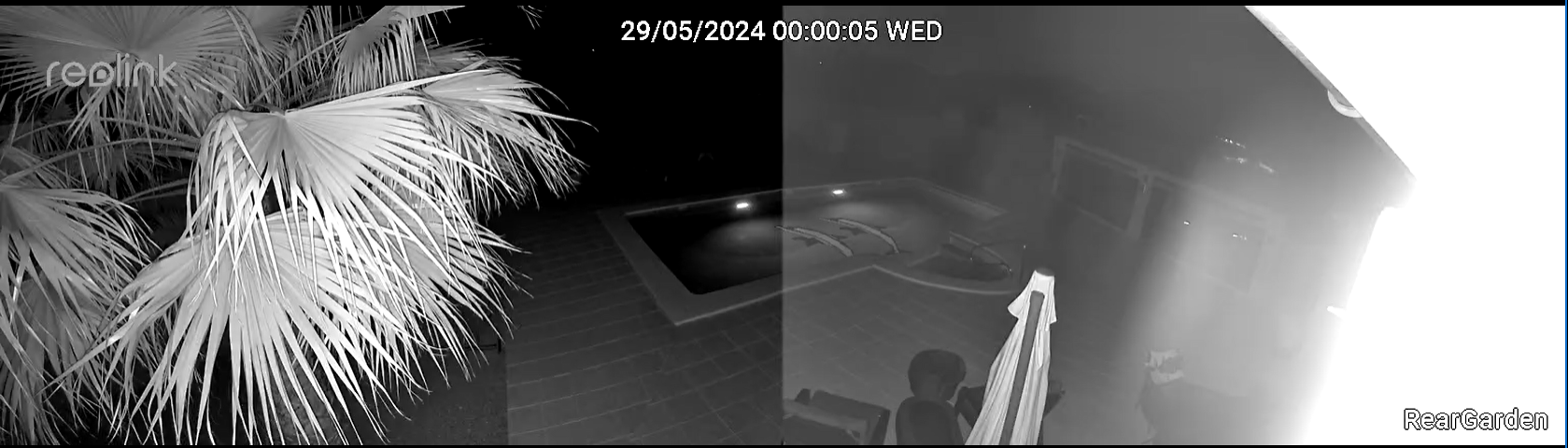

Finally mounted the cameras now. I can see what people say about the night time quality of Reolink cameras. I'd have hoped they'd be better than my old Nest cameras from 2018 but it seems on par.
Can *just* see where the 2 camera lenses stitch the images together. With the pool wall being slightly bent and the paving being slightly different shades.
The colour difference is then exacerbated in the dark.
I think part of it is because of how i've mounted it so some of the light bounces off the wall to the left. However the front camera does similar and isn't mounted as close to the wall. In theory this wouldn't be an issue at our actual house as i'd have more cameras/better mounting.
The day time colour especially is a bit annoying as suggests calibration is off. The field of view is cool, but i do wonder if i'd be happier returning for a single bullet style cam. Especially as in my actual house i'll have more cameras installed and so don't need as wide a field of view.
EDIT - Also, there's clearling a missing gap where the cameras meet. It says it's set to 8m, but i was probably around 8m away and have half a head!
Have a fiddle with your IR settings (On/Off) and dynamic contrast. My Left Garden camera is a nightmare for spiderwebs (pretty sure they're attracted to the IR lights) - I have to turn the IR lights off, set the camera to B&W and slightly adjust the Dynamic Contrast up, which avoids bright reflections from the web, back into the lens.
It does mean one camera is constantly in B&W, but the Right Garden camera overlaps the coverage - the Left is our most vulnerable point (Ground floor extension, with flat roof providing access to our girls' first floor bedroom window).
Anyone attempting entry there will get picked up by both cameras though, in colour AND b&w.
