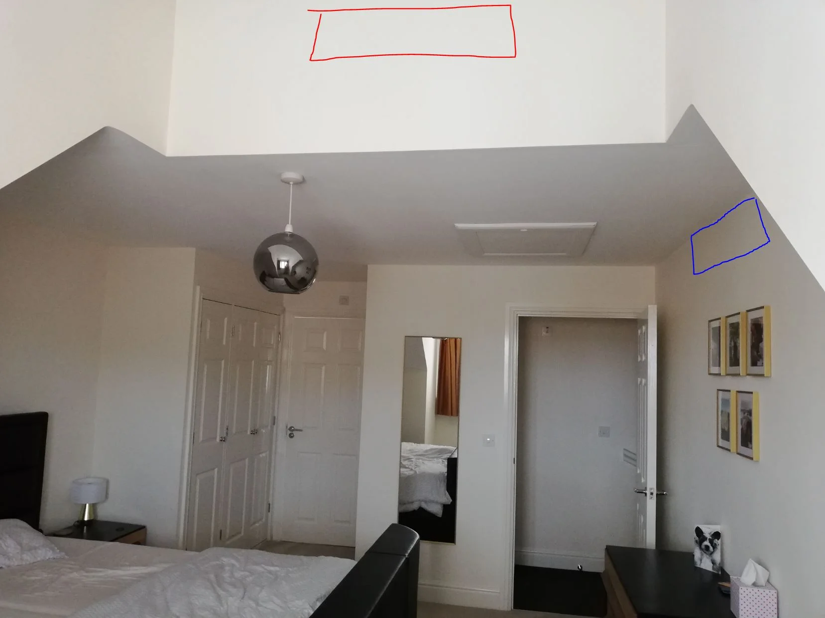

Originally I was thinking the unit could go where the red box here is as it would be completely out of sight too, and all pipes could be directed out through the brick wall in the loft (external wall is on the left of the picture where my head board is). The chap suggested to put it on the wall opposite my bed (blue box) and have a pump in the loft for the condense.
Just wondered how much room there is to get the unit up then run all the ducting.
You could have the return air duct above the door and the grill just below the red square.
They would install a small inline pump within the unit - would you leave it running all night?
Also amount of condensation is going to be hard to determin, as this would also depend on the coil temp, if the unit on low load then the coil temp would be higher and not produce much condensation.
There is an ok amout of room in the loft, as technically the bedroom is in the main part of the house's 'loft', it is only the very top that I have left but I can stand in the middle with a bit of room above my head.
It will be left on at night if we have carrying on having the hot summers. Ideally like the bedroom to be about 22c max for night time sleeping but we were stuck at about 26-27c (and humid) last year by very late evening.
We had a mobile unit in there last year ducted out the window which is right next to my side of the bed. I could not sleep, it was so bloody loud! I turned it off and suffered the heat ;)
*edit* I mean I could just tell him to put it where the red box is on that picture, as then it could rely on gravity for the condense. Perhaps it's not as efficient blowing in that direction (a slanted roof, towards the window). I would have thought the higher up it is, the better.
You could do that, As that might also be a hotspot as the warm air will rise, only thing you don't want is to short circuit the air.
But if you put it low enough not impede the condensate.
Least you got room for a ducted unit - have a word with them and triple check.
My unit is in the hall upstairs and I need to have a fan blowing into my bedroom to cool it down. I only have one out side wall and this is at the front - I would need to install a ducted split for the best option.
I've emailed him to see why it shouldn't go where the red box is. I'll then ask him about the ducted unit depending on his reply.
