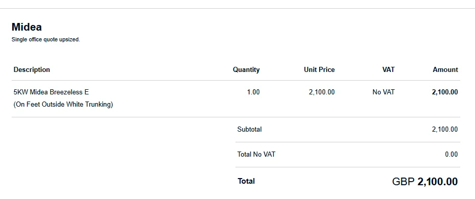

I did get a quote for a single, larger unit for that office, which may be strong enough to keep upstairs cool on it's own:
