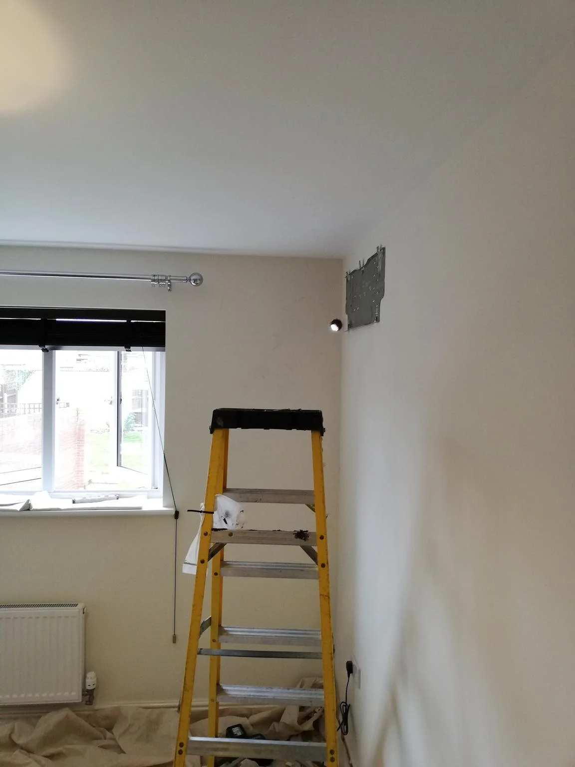

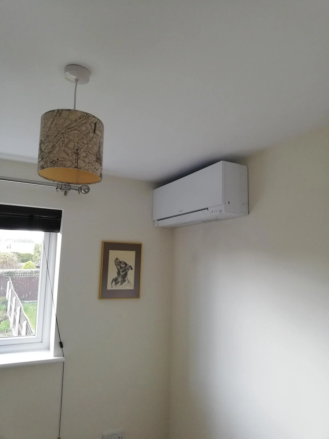

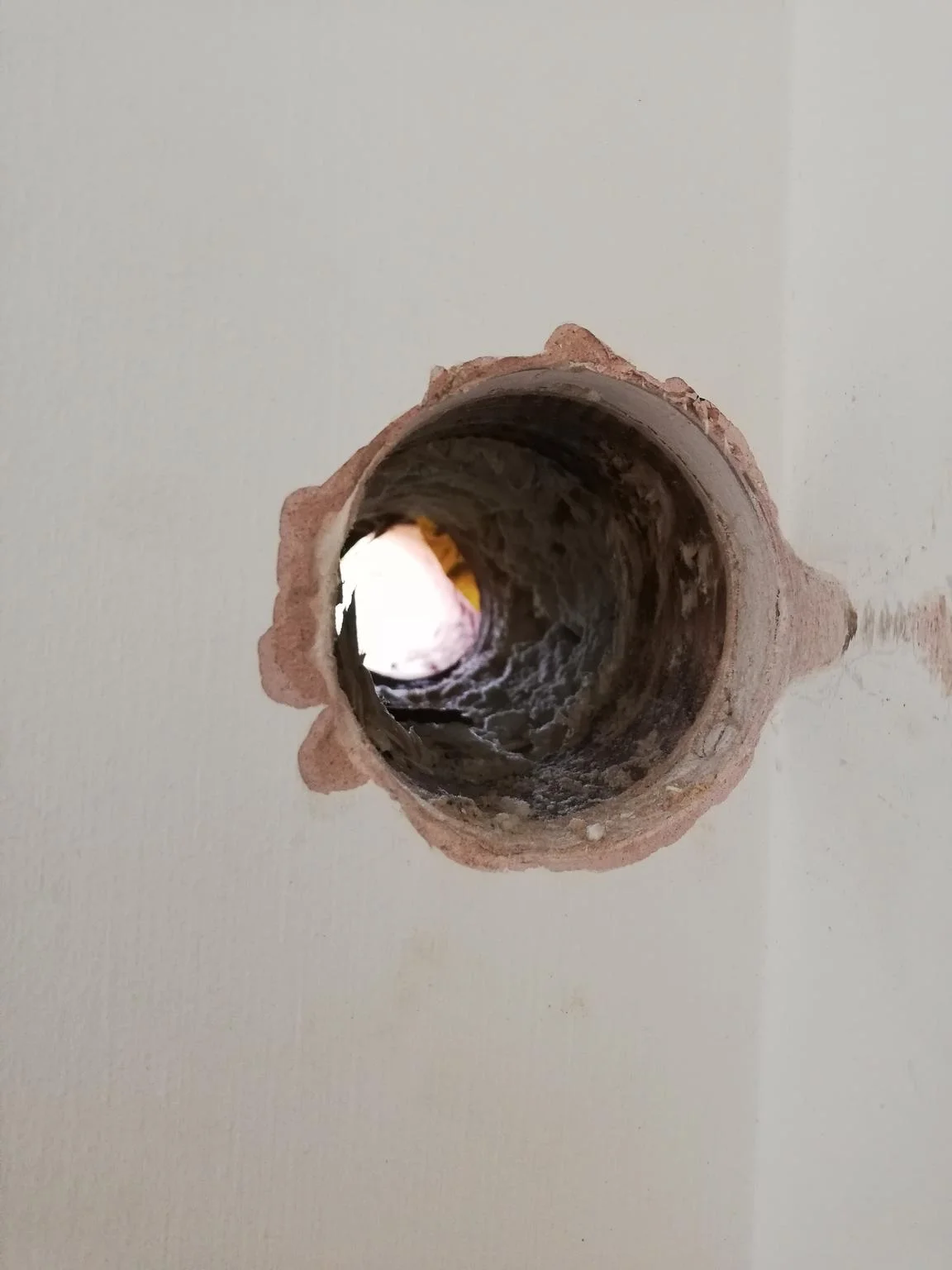

Both my rear bedrooms (one used as my office) have been core drilled and units fitted (both look identical). Before they can fit the master bedroom unit, scaffolding needs to go up above my garage so they can safely drill through (its very high up).
Close up of the hole. Walls look well insulated :D
I wont bother posting a pic of the rear of the house until everything is finished but it looks very neat so far. Things didn't go to plan with the outside trunking due to where the core drilled holes had to be but despite that still very happy.

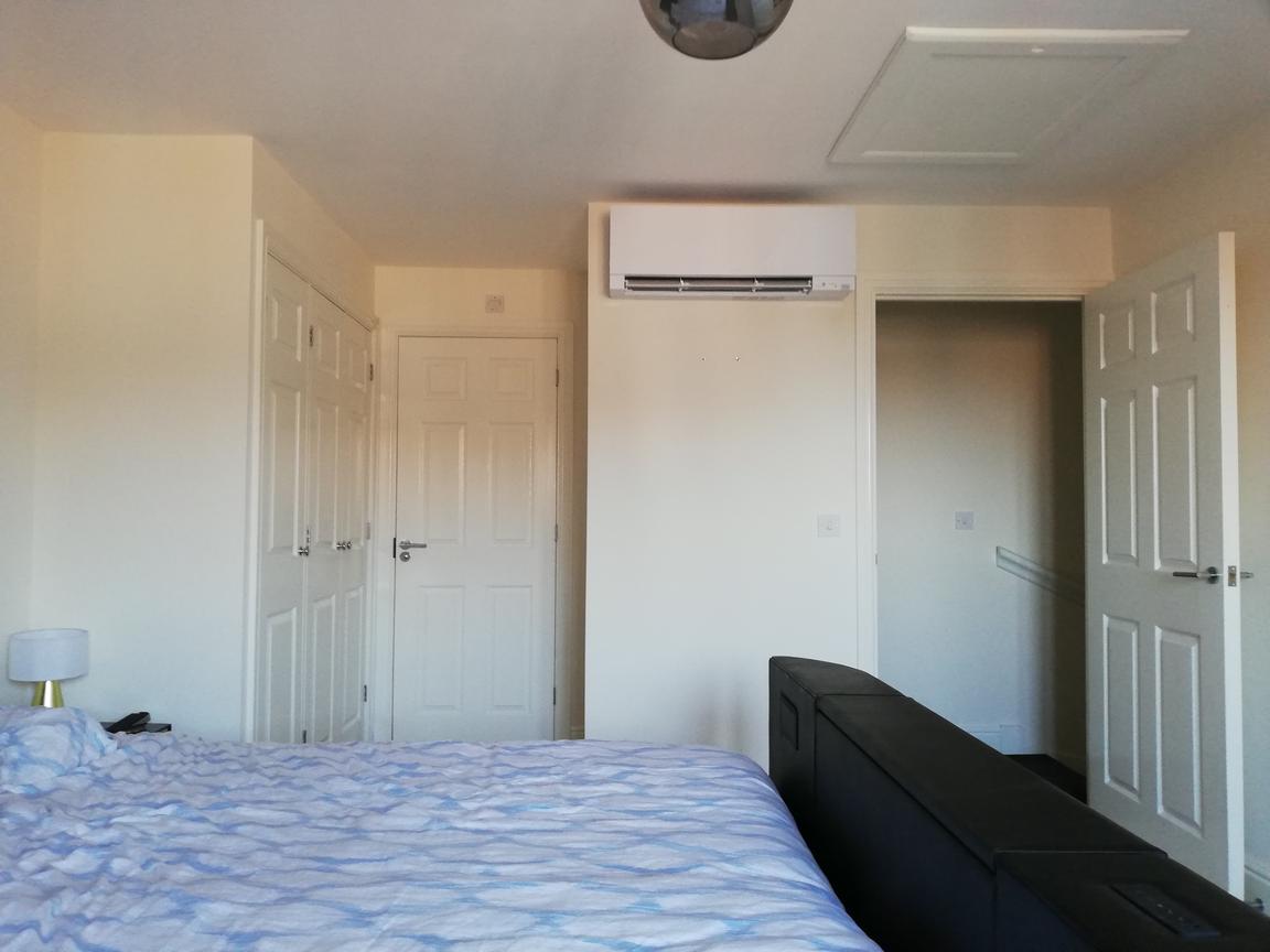

I had my install finished today. Very happy. Internal units are very quiet, easily controllable by either the remote, or by the app over wifi (loads of options for setting times for it to come on etc). The external unit also seems quiet too when all 3 of my rooms was fired up at once.

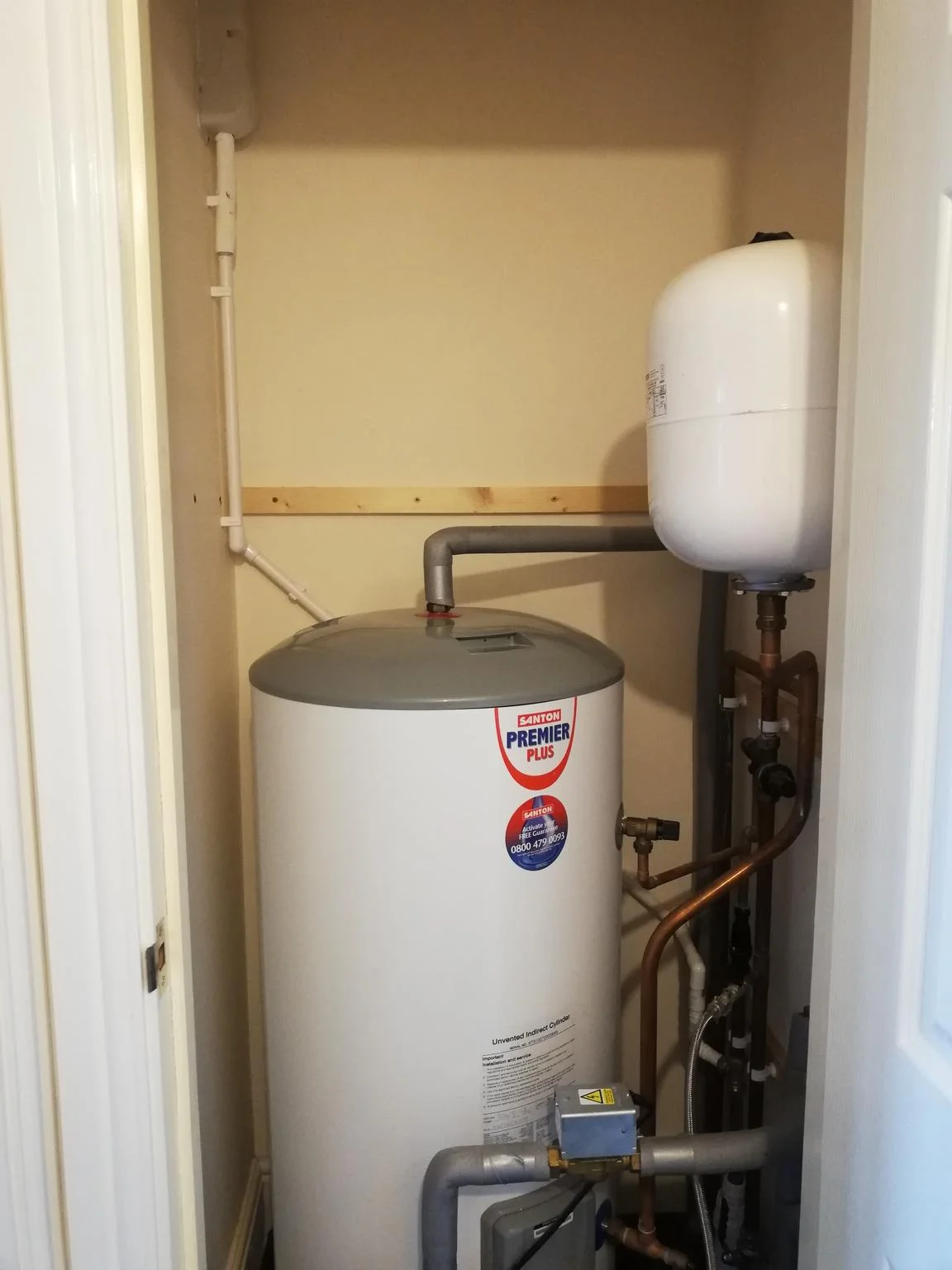

Master bedroom unit - no longer needed a condense pump as behind the wall it is on there is a drain in my cupboard for my water tanks overflow. Very handy. The gas pipes go up in to the loft, out the gable end of my house and down to the back of the house.
Inside the cupboard directly behind the master bedroom AC unit.

That was handy having the condensate going with the water tank :D
if you can add the condensing the condensing unit tomorrow, be nice to check the pipe work.
Hehe yup. Hopefully saved myself a headache of a condense pump malfunctioning.

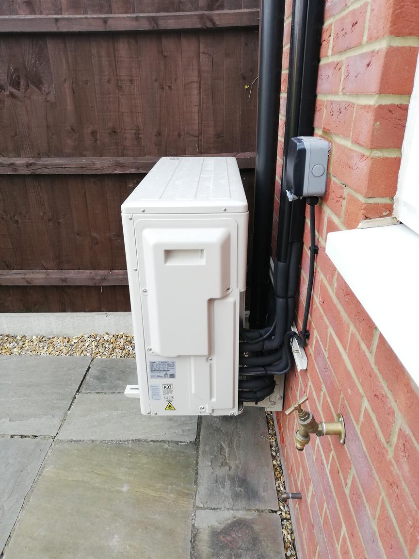

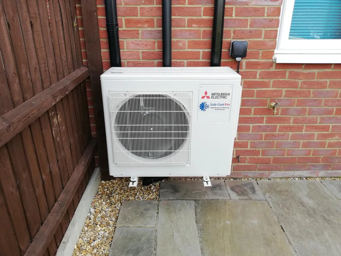

Here is a pic of the back of my house this morning. I originally wanted the trunking below the windows to be high above to make them less obvious, but this wasn't possible due to not enough ceiling height in the rooms to allow this. Both back rooms exit points are approx 50mm below the tops of the windows, they trunked right up to the top for a cleaner look I think.
External unit close up:
Side view:
Anyway, hopefully the pics are useful for someone else thinking about getting a split system and what is involved.
