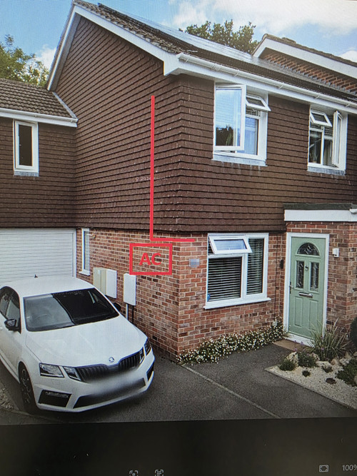

Emailed a few companies, but all are super busy (shock) but I was only trying to see how they deal with tiled walls and AC ducting.
Anyone have a split system and a house like mine.
Was thinking one up to bedroom and one round to the living room.
Any photos appreciated.

When I was getting quotes, fitters refused to drill through tiling like that on our house. They only offered to go into the attic space and install ceiling units instead.
That's a bit crap, I get that they are not roofers or whatever, they are AC installation technicians, so not their trade but you’d think they'd just remove a tile and go straight though the wall, and have it written into the deal the homeowner is responsible for making good the entry point afterwards
It's more than one tile though, they'd need to remove an entire strip to mount the ducting / pipework which would likely be very difficult to "make good" again afterwards. In that example photo above, the entire column of tiles would have to be removed to allow them to affix the ducting properly. It's pretty difficult to figure out which tiles would need to be removed for the coring too as they'd likely drill from the inside going out.
Ahh fair enough... That's a bigger job then lol!
I was thinking they could run the hose for the upstairs in the cavity wall but I guess that's a can of worms too.
I'm guessing it's best to have pipework as short as possible especially outside in the sun.
I wonder where they'd even put an outside unit on my house without it being in the way or some crazy length to the pipework. Side of the house would be best but that's over the garage roof (tiled sloped roof).
