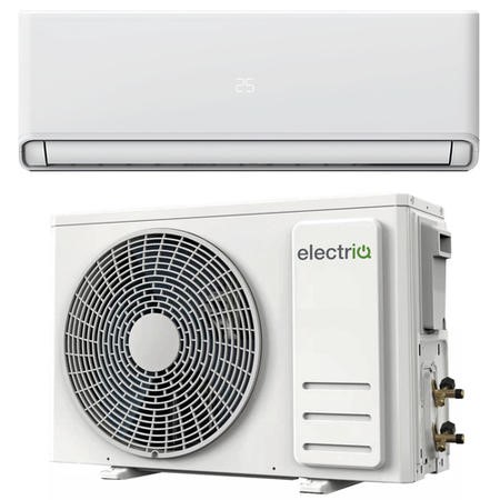

Hmm, what about this?
  • Contains everything you need for installation, does not require installation by an F-Gas registered engineer or specialist equipment

Really popular in the states by Mr Cool etc., the line set ships pre-charged with dry break connectors. You simply buy one with a line set longer than what you need and coil up the excess. Every bit as good as any other mini split no reason to suggest they are in any way inferior. I thought they had been withdrawn from sale in the UK after a strong pushback from REFCOM. Obviously they don't like it when you make their f-gas engineers unnecessary. The F-gas guy I had commission my unit had a fair bee in his bonnet about AO selling splits direct to public. Was still happy enough to charge up a system which I'd installed myself. £250 to pressure test, purge for half hour while eating his lunch then open the valve. If one of those DIY systems was an option I'd gladly cut out the F-gas man, the only difficult part of the install is core drilling the wall.

I'm not sure that all the "No F-GAS installer" ones are dry break connectors anymore. I think there has been a bit of a change of the rules, I understand that small systems using R290 don't require an F gas ticket to install anymore as its basically camping gas, although there always was a bit of a disconnect with some of the other refrigerants.... I could buy a top up can for halfords for car AC, but I wouldn't be allowed to top up my conservatory aircon even if it was the same gas as the car.
From the site selling it: "Eco-friendly R290 refrigeration gas with zero ozone depletion potential (ODP)"
Interestingly enough, when I had the system in the conservatory installed (by an AC guy who did it as a barrow job for me), it was just purged with a bit of the refrigerant, rather than being vac'ed out and pressure tested with nitrogen as per the proper way. So even those with the correct ticket do sometimes cut corners
