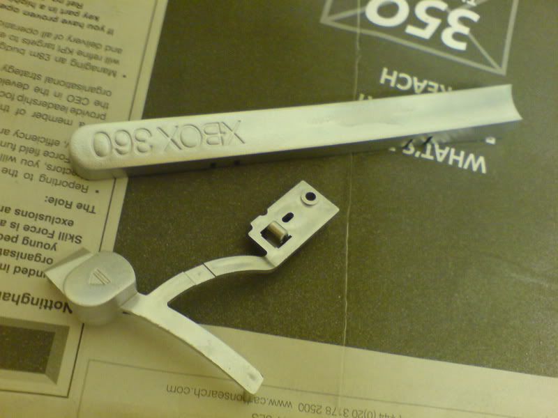

I found a small can of Plasti-Kote in Focus today for £3 when I popped in, so bought a chrome one, and tested it out on his DVD drive bezel straight off, just to see what kind of look it'll get, its currently in the garage drying!
Not overly sure how well Chrome Drive bay and yellow case will work hehe :) and i'm trying to think what kind of look yellow over chrome might pull through, hmm! :)

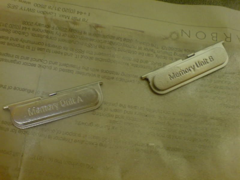

Ok, here goes, excuse the bad quality, SE K800i with flash = too bright, without, grainy as you can see!
The memory card slot covers ARE the same colour, irl! :)
