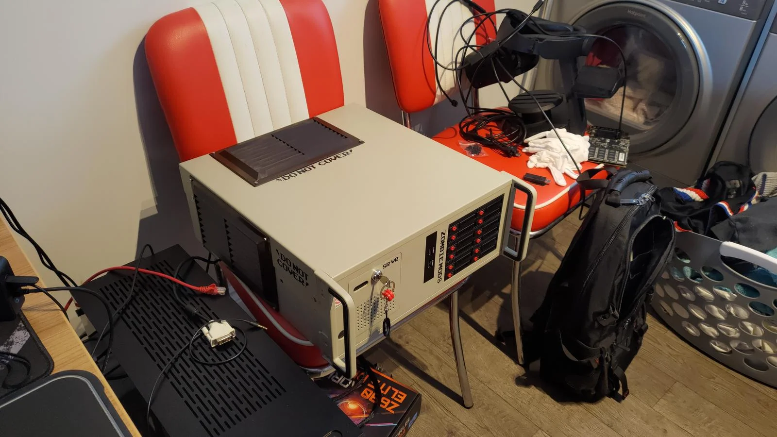

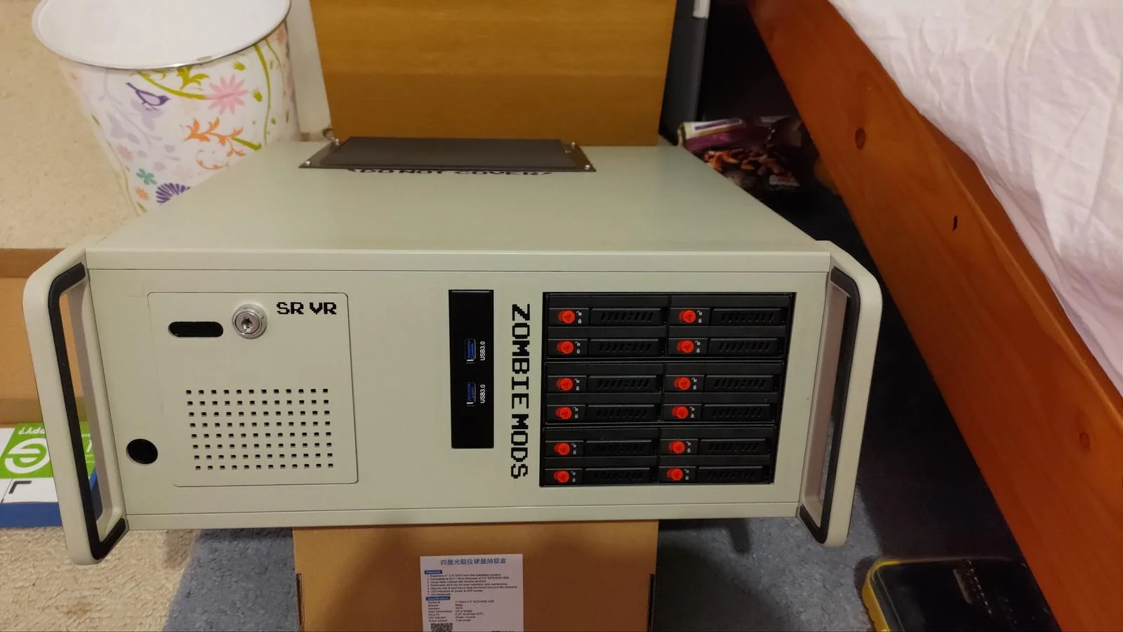

Sr Vr. The ACME server.

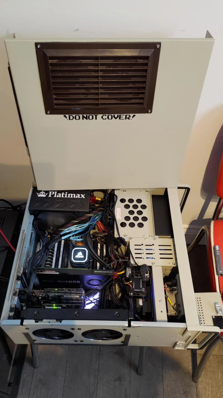

Right, all ready to be packed and then dragged up to the top of Mt Everest (my flat with its 108 steps). Not looking forward to that tbh.
I also bought another 3 SSDs. Three Intel 180gb drives for £14 each. So the racks will be full.
OK. Apologies for the radio silence, it's been a bit of a crap week.

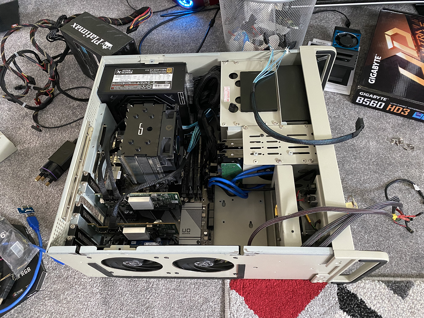

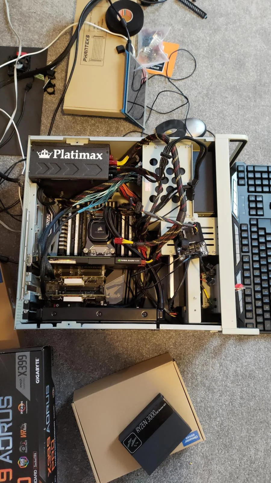

I got home and lugged everything I needed up the stairs. Sucked tbh. Started building it that night, and immediately noticed an issue. Whilst everything fits how I planned it to I did not realise the USB 3.0 header would be covered so tightly. I thought it was up the side of the board like 99% of the boards I have used in the past so didn't pay it much thought. That was a mistake. It doesn't fit no way no how. There may be a way around this, and I will try, but as of now no front USB.
I also realised very quickly that I should not have stopped after shortening the 24 and 8 pin. Space is a premium in this old chassis, so that bit me.
That was after an over two hour fight with the PSU. Let me cover that also. Firstly the mesh grille was rubbing the fan. So I had to use the old frame as a spacer. Not a deal breaker. However, I soon realised the connector in the PSU for the fan made no sense. I figured it out eventually, and got a lovely electric shock for the convenience ffs. I also found out that yes it's a 140mm fan but Enermax used 120 mount holes. Meaning I had to drill the fan and mess around with it for ages. UGH. Then I found out it's just a hair too thick so had to mod that too ffs. I got that done, and then the next day I shortened the PCIE power cable.
It's not finished (needs final cable ties etc) but lesson learned from the past don't tie everything down until you are sure it all works.

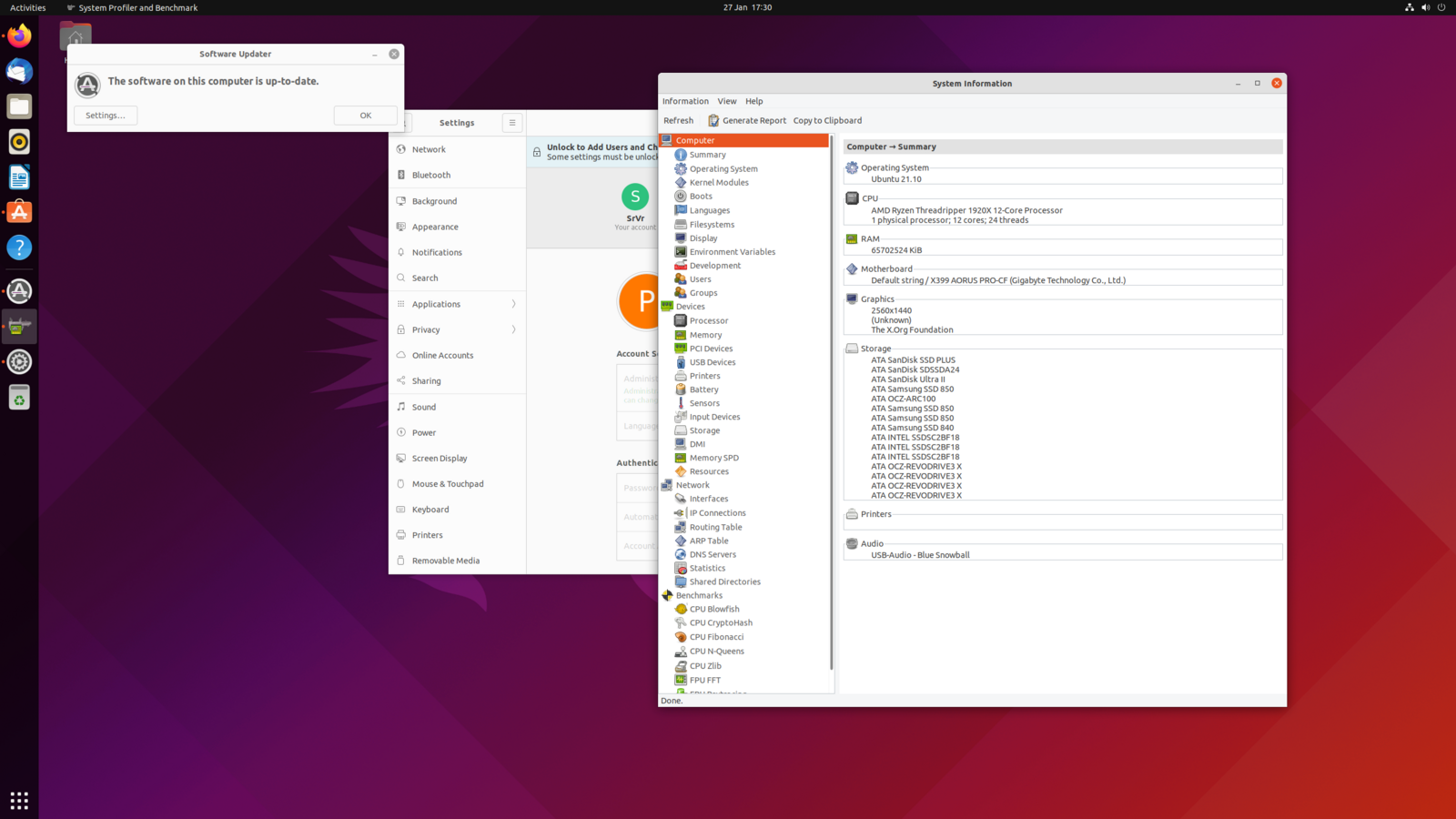

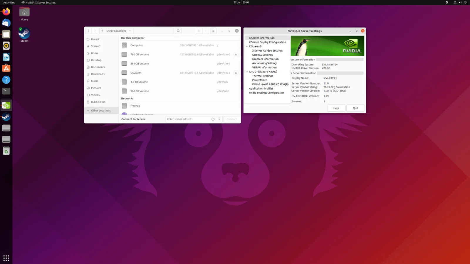

I already had Ubuntu installed but it was giving some AMD error at launch. I got around that by connecting it to the network and installing a couple of updates via terminal. The rest? has been slow going, but that is what you get when you are in an alien OS that you have never really dug deeply into before.

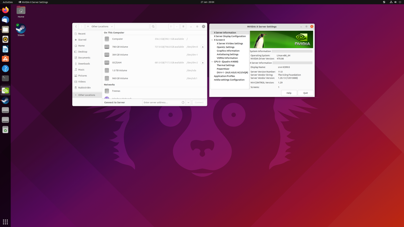

It took me the best part of a day just to install the video driver. I downloaded them from Nvidia but they came packaged as a .run file. I then became blinkered by this, and it cost me a few hours. Firstly when I tried to launch it it was telling me I needed to be logged in as root. However, when I did that I could not see the DIR structure. I then found a way to make myself root, and launched it. Then it told me it was unhappy about something else. Many hours had passed now and I was peed off with it so I started having a look around Ubuntu and happened across the software update part that also has "other devices" listed. Sure enough, there it was.
However, I then noticed another problem. See if you can spot it.
I will come back to that shortly. The next step was figuring out how the heck you combine volumes in Ubuntu. Back to school I went. Found out that it was all done by terminal unless you used a GUI. Cool, so I set about finding one. I eventually found the respository for KDE partition manager. However, when I watched a guide on the internet it was making no sense and didn't even look like the one I was using. I then looked at the help guide, but again the GUI was completely different.
It seems it has been updated (the GUI/app) but the documentation hasn't. Eventually after a few hours I figured it out. And created my spanned volumes.

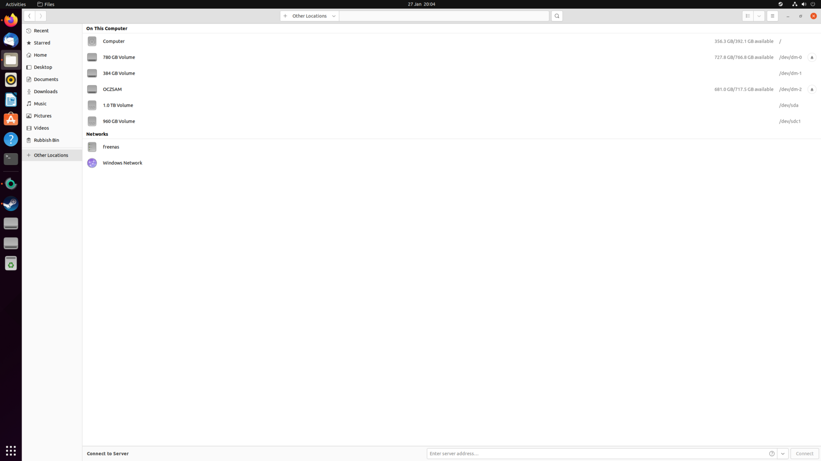

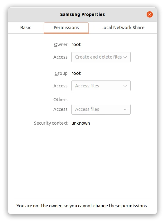

Which all worked beautifully. However, you will note something is missing. Look closer...
Yup, no Revodrive X3. Now if you cast your mind back to the first picture of Ubuntu you can see it is there. However, it is there in four parts. That is how the drive works. Four 250gb Sandforce SATA SSDs all hiding behind a Marvell controller. Now when I first saw this I figured "Hmm, no RAID but I can span the volumes to make the drive back up into one piece". Only you can't. It only allows you access to the first 250gb. The rest? can not be partitioned or formatted in any shape or form. So basically? that will have to come out. There was a hacked together user driver created in 2011, but I can't find it.
The good news is that you can see, we have the rest of the SSDs all picking up, detected and spanned into volumes.

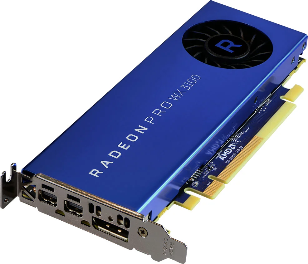

Which I purchased here today. Was £80. I have 32gb RAM over 4 sticks, DDR4 3200. Which IMO will be the biggest upgrade. Problem is I have two X4 SAS cards, and no onboard with the 11400F. So I bought this for £31.

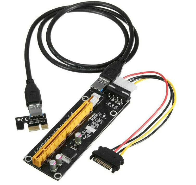

And will need to find a way to get everything running. My first option is X1 mining riser for £3. Which I have also ordered.
Which I hope will just work from one of the X1 slots. If that fails and I get no signal out? I will need to try something like this.
We shall see. I bought that GPU specifically as it is low profile, and will have room under it for whatever I need to get it working.

Yeah I suppose I could do that. Would rather not though tbh. The mining adapter was £3. Beats hacking up a board. Besides, I got the GPU because it is low profile, so it would not work any way. As it stands I can screw it in at the top of the PCI bracket, then I will have space under it to add a mining riser.
I think most GPUs will run at X1. That will be why mining risers work. However, if it does want X4 (looks like it is only wired for that any way !) then I can get 4 lanes out of a NVME slot.
Ah, I'd missed that the other end of that was an M.2 slot.

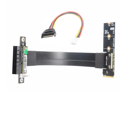

Yeah that is the backup plan ! £13 from Ali. Will try the mining riser first, which will let me know if it will post in a X1 (as that is all it does, an extension if you will). If it won't I can go nuclear and grab one of them NVME X4 to X4 or above (they do them into a X16 slot, tho obs only wired to X4).

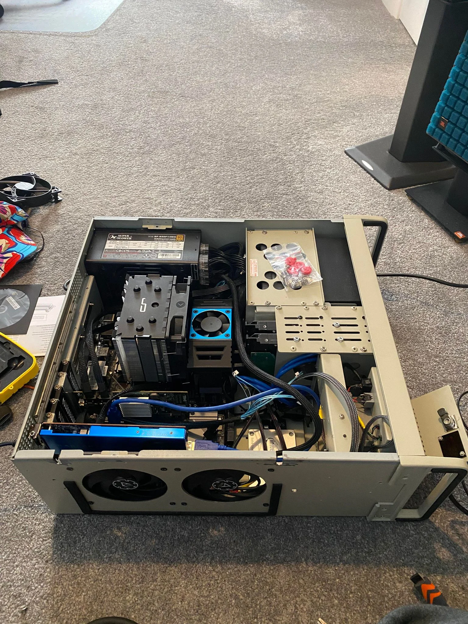

Board is in, CPU fitted, cooler fitted etc. I also switched the PSU as the cables on the Enermax were awful. Extremely stiff and annoying. I put in a 850W I got here from the MM for £30. Much better.
The intake fans were in the lid before. They are Arctic thin models. Obviously now I can't have exhausts in the lid, so instead they are just huge vents now.
When I get back I will have the GPU with me, and will order 12 1tb SATA SSDs. Then I will do the software work etc.

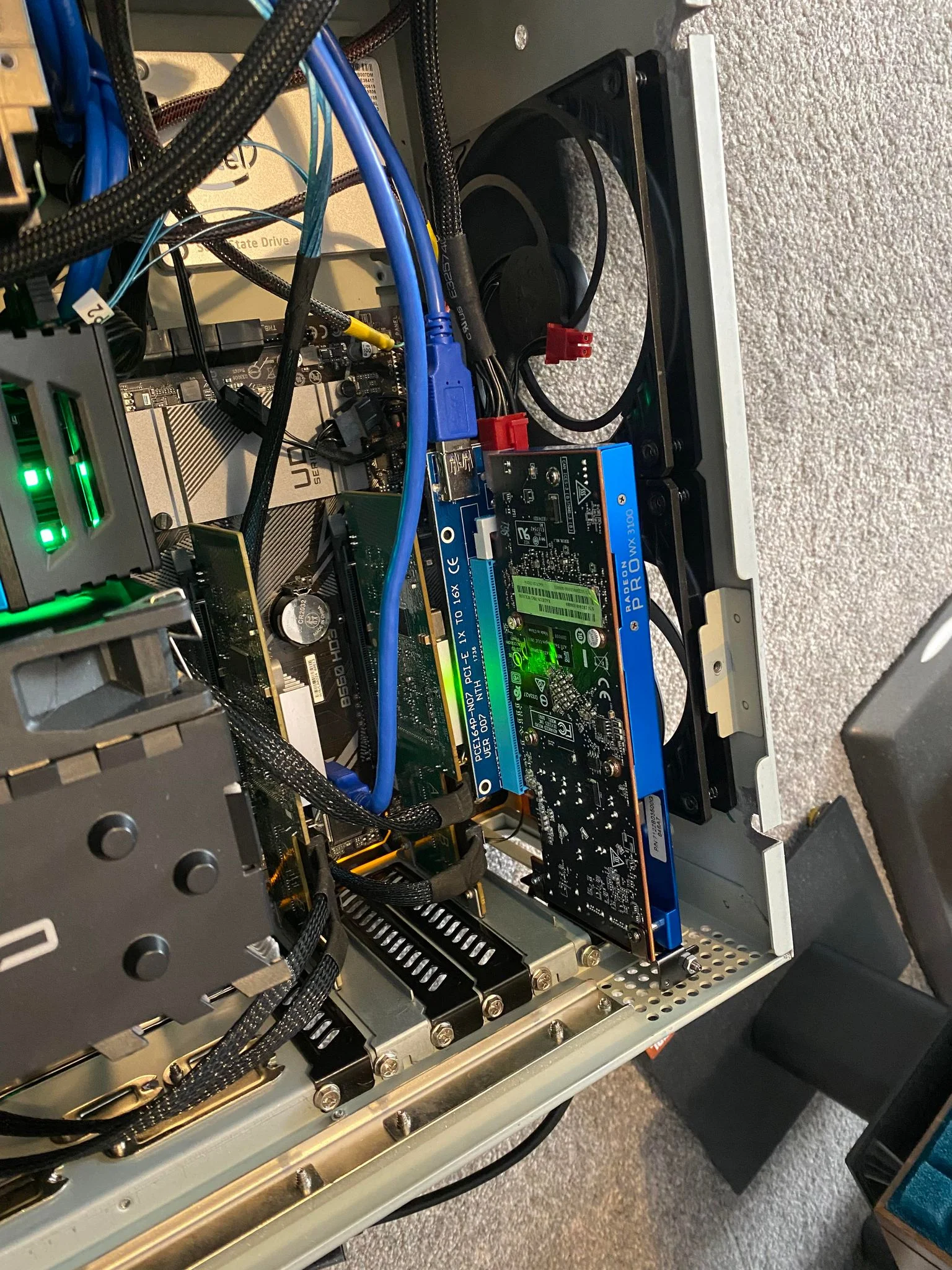

OK. So it is back up and running.
I ended up using one of the 180gb Intel drives for the Truenas install.
The GPU worked perfectly on the mining riser, but not without a 6 pin PCIE power connector plugged in.
Unfortunately the SAS card got in the way a bit. BTW, that SAS card is warped that is not anything touching it. It has always been like that. What I had to do was grab a mobo mounting post (UNC) and then screw that into the PCI screw hole. Then add a Corsair M3 spacer for a AIO, and then use a nut to secure the GPU. The underside of the riser is insulated with neoprene, so there is no danger. It isn't ideal, but then it works. Thankfully it is Displayport only, so I have a DP to HDMI in there permanently meaning you never have to poke the back of the GPU.
