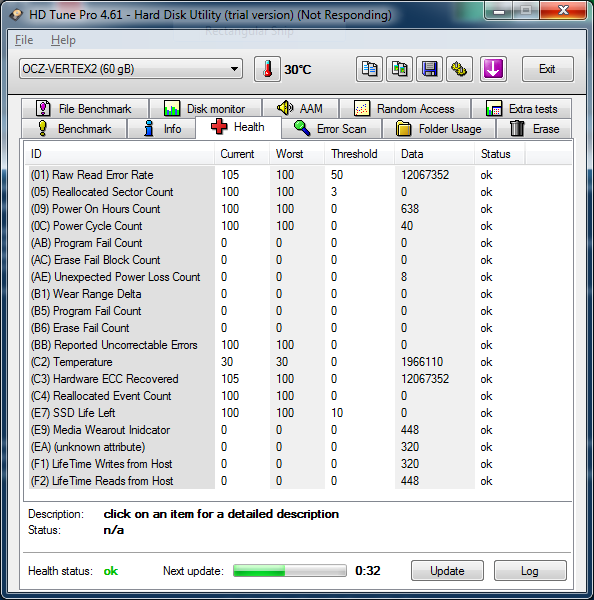

Basically my system will go unresponsive for around 30 seconds, can still move the cursor and stuff around, and then comes back. I've still to run Memtest to see if the RAM is the issue, but I get the feeling it's the SSD. It seems like it's mainly programs that are on the SSD that are locking up the system, I've got EVE running in the background and generally when the system locks up it will continue to run fine.
Is there anyway to check the SSD for errors and see if it's causing the issue? I could boot into another install and see if that works fine, but was wondering if there was another solution.
I did reinstall Windows as before the locking would cause the machine to reboot, now it comes back after a little.
Motherboard is the original P8P67 Pro, SSD is a Vertex 2 60GB.I have the latest firmware for the SSD, haven't tried changing the SATA port it uses though.
Trying to run the error scan and it either runs really quick, or isn't running at all.
Is what I get from info, anything there looking bad?
