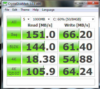

Hi, I've had this OCZ Agility 2 90GB for about 18 months and im sure it was a lot faster when I first bought it, What it should be:
Maximum Read Transfer Rate : 285 MBps
Maximum Write Transfer Rate : 275 MBps
Just taken this test
Does that seem right?

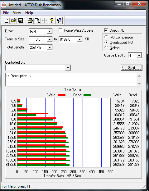

run atto benchmark and see what that says
According to Atto, It's running as it should?
Do you have CPU C2/C3/C4 states enabled in BIOS? If so disable these and test again. I have had something similar with slow 4k speeds on a Samsung 830 and it was due to this.
If ATTO says it's running as it should, then it's fine. I personally find ATTO much more reliable testing SSD speeds over CrystalDiskMark.

This is perfectly normal as crystal disk uses non compressible data and cuts the speed in half near enough. Plus after a few weeks of using the ssd non compressible date write speeds slow down even more.
It took me quite a few months to figure why the write speed kept slowing down when writing non compressible data, as I was always secure erasing it after a few weeks to get the speed back up.. But now that I know this is normal, I just accept it and plus most of the data that the ssd reads/writes is compressible anyway, so its not really a issue, unless you run games from the ssd.

CrystalDiskMark and HD Tune are terrible benchmarks. Atto is good I had a similar issue and created a similar thread.
But like I said, its all todo with, if the ssd can compress the data or not. If it can compress the data, you will achieve full speed and if not, you wont.
Today's ssd's dont rely on compressing data to achieve the full speed anymore, I dont think anyway, but I could be wrong?
They arent bad.. they just arent skewed into making things appear faster than real world situations just to satisfy Sandforces marketing material.
All Atto does is write "0"s or "1s".. as if were all going to be storing a huge 100GB text file full of nothing but 0s...(never going to happen).
But most things must be compressible, if this wasn't the case OCZ wouldn't go down this road to achieve their speed, would they? Like the only thing these drives are rubbish at, are games as they cant be compressed any further. But this is fine, as SSD's back then you were only suppose to put your OS and apps on to them anyway, so no probs.
