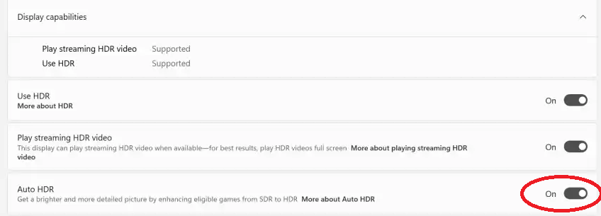

Although it's happening on the non-HDR screen, can you turn off HDR and see if it still happens? I remember W11 having some weird auto HDR thing so it could be applying it to all monitors instead of just the HDR one, if @Cooners 's TV is also HDR that could also explain why it's happening to him as well.
Yeah my next step was to confirm it definitely did go back to normal if I moved it to the HDR screen. Unfortunately even though it's been immediately reproducible on the forum update thread it's just not doing it now, I found the email it did it with too and that's not doing it either. For what it's worth the second screen is a Dell P2417H plugged in via HDMI, the LG is plugged in via display port.
I'm suspecting it's the auto HDR feature which tries to enhance SDR games to HDR, and for some reason it was picking up Chrome as a SDR game, which may look fine on a HDR screen, but messed up on a SDR screen. Windows should limit it to the HDR screen but for some reason it carried over to the SDR screen. Maybe turn that feature off (you can still keep HDR and HDR video streaming on) if it happens again:
I've had that Auto HDR setting on since I've had the LG monitor. There has been a new Chrome build released in the last day or so with an install date on my PC of yesterday, maybe that fixed it and is why I can't reproduce it now.

Just for the record auto HDR was turned off on my system.
