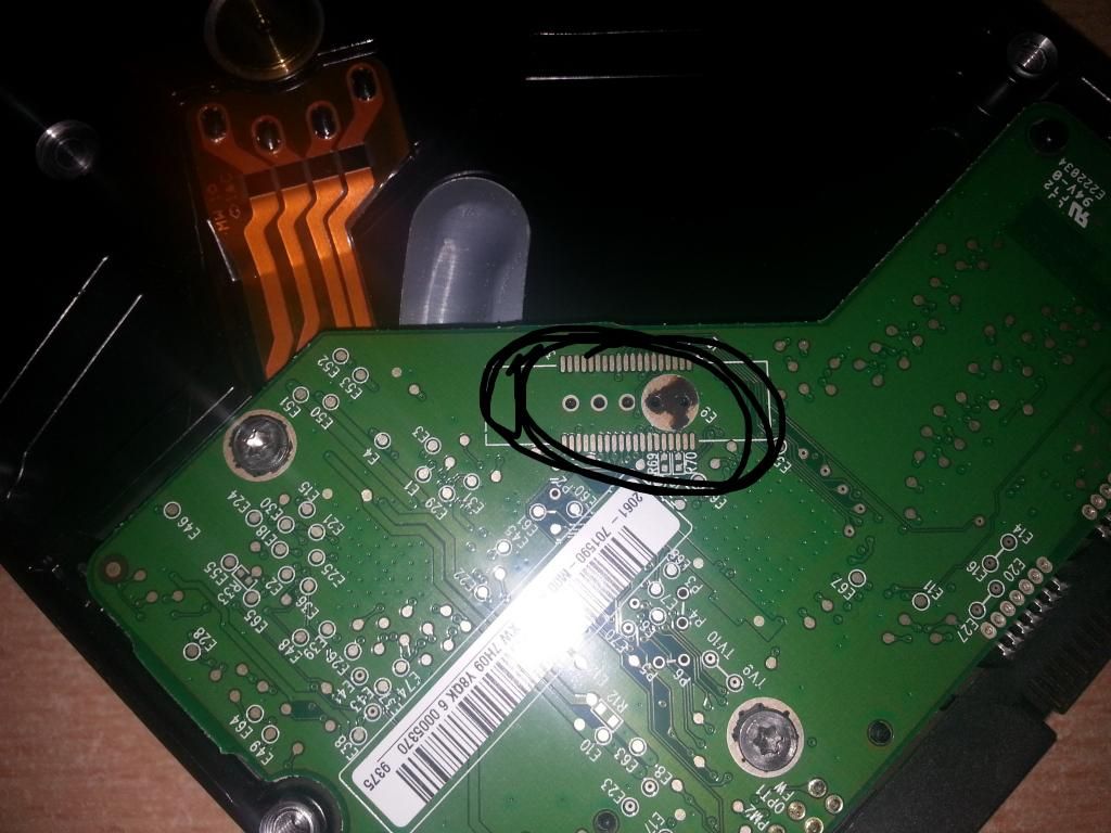

It was registering a bad sector after it ran the chkdsk when it was having problems reading the drive and the WD tool wouldnt pass teh SMART test, came up with error that points to bad sectors.
Here is an image of the bottom of hte HDD and I have circled a mark that seems to be a short by what seems to be a burn mark.

Seems like its happening still, same SATA port but different hard drive and different SATA cables, I am starting to think the port is faulty.
Switched it with the DVD drive now, will see how I get on.
