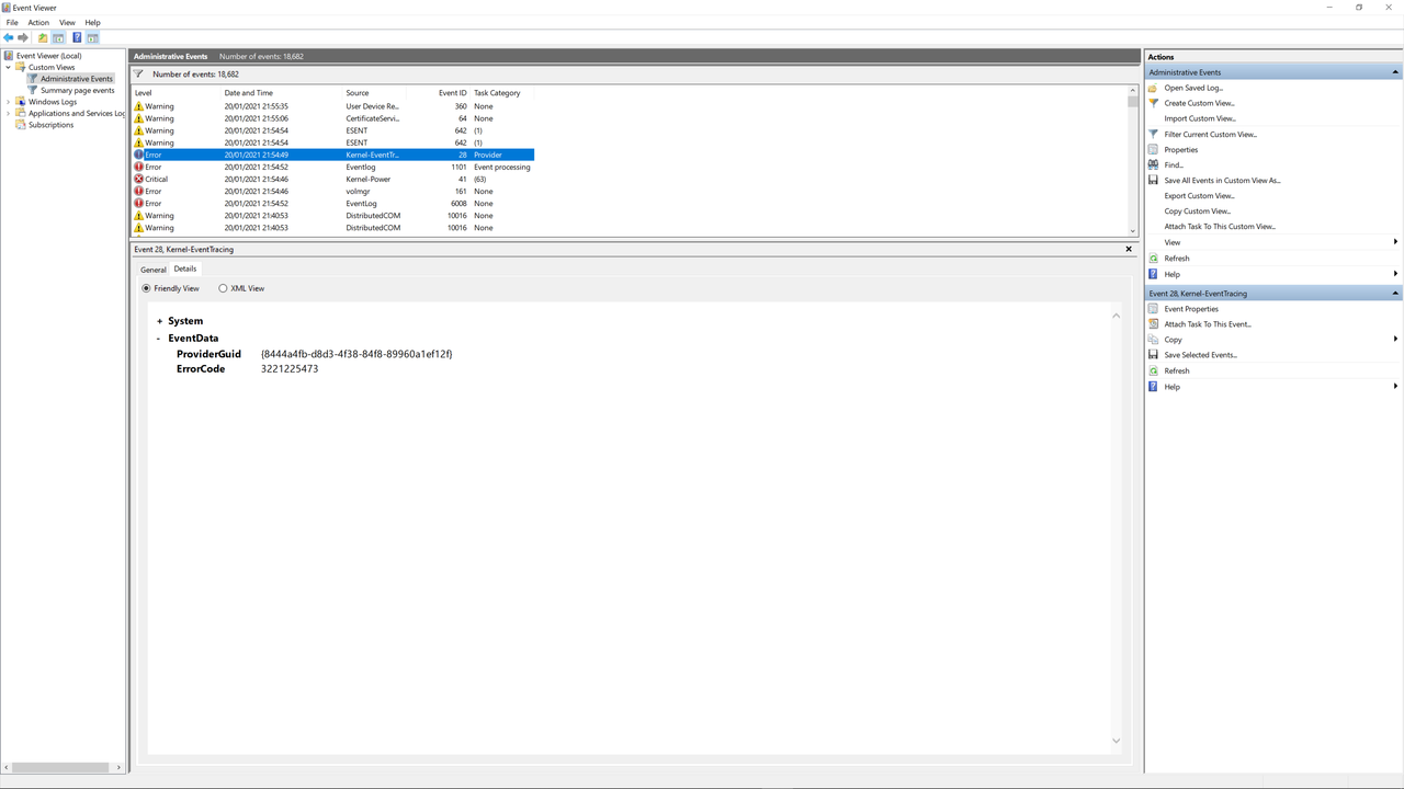

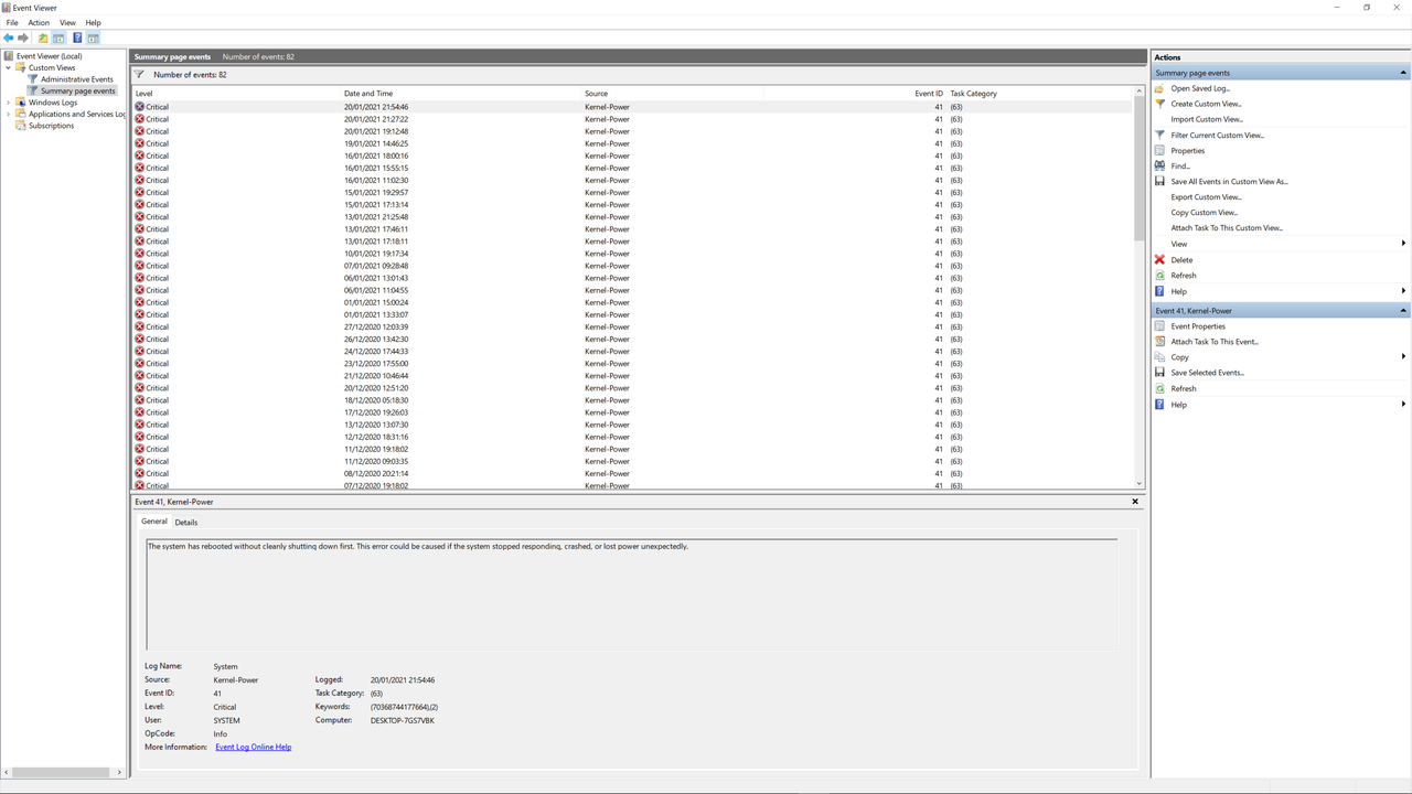

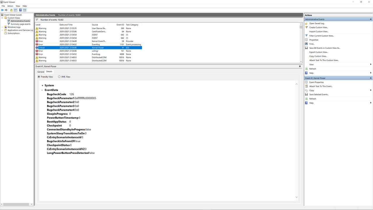

Just checked again and noticed this:
PSU related? I'm not massively familiar with Event viewer, so excuse my ignorance!
If you have a look in event viewer > administrative events then look for the error events that occur just before or after the critical errors.
Ironically just had another one there whilst in event viewer, seems to be happening a lot more regularly now.

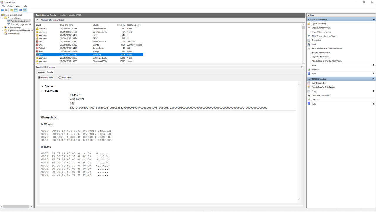

Added more pics hope these may shed light on it?
