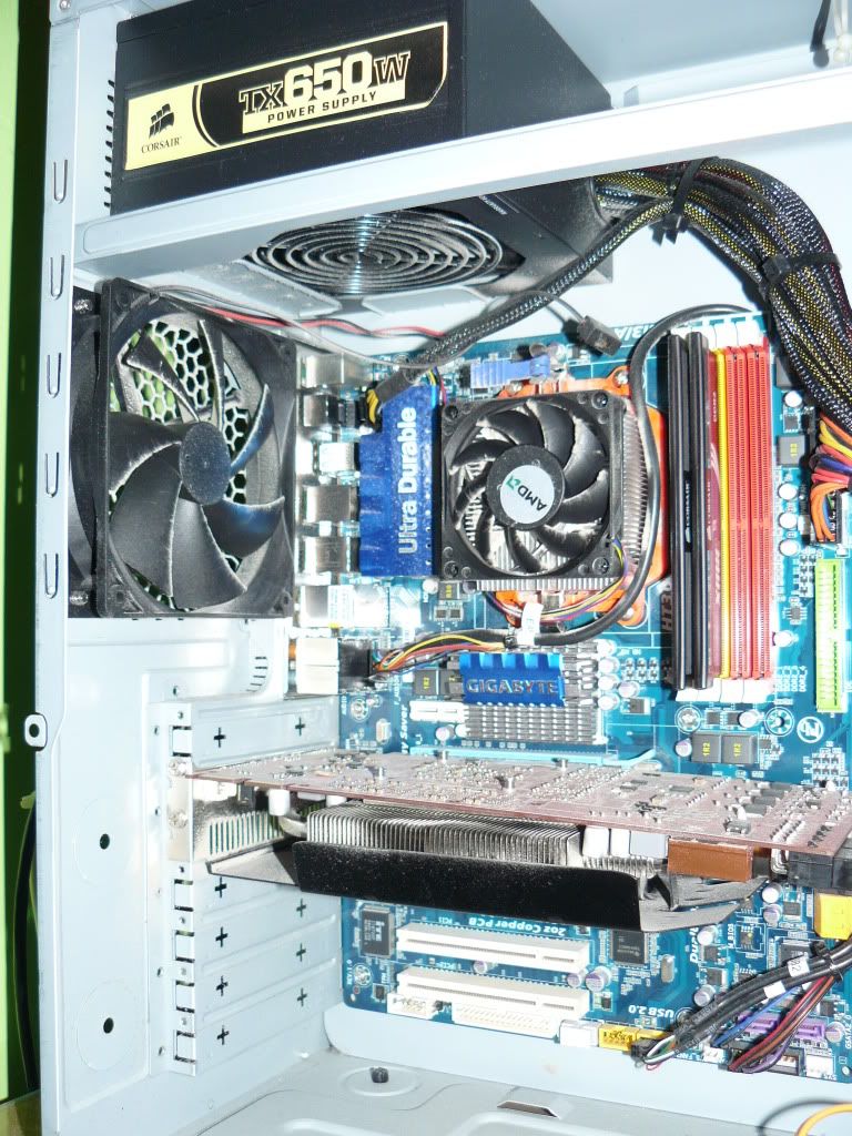

Would this photo help mate? Btw excuse the dust lol

and in answer o your using an extra viper fan as a case fan, you might as well strap it onto the other side of the cooler (so one on the front pulls air in, one on the back sucks it out)(, and keep the current fan you got in the picture where it is
Now that's a great idea with having one sucking and then blowing out i like it. But that's what i wasn't sure would that vipor fit with my current set up and blow straight through the back mate? Thanks again
No tower cooler that fits using a standard socket mount will blow out the back on that motherboard. Mounting bar goes north-south so radiator will always go east-west and fan blow north or south, so to speak. And you cannot change rotation that on an AMD mount unlike a 775 mount.
The only choice is a hsf that removes the socket and mounts direct to the mobo and a lot of those can only be fixed one way too.
This is a real toughy. The Ultra 120 is about the only one I can think of as suggested above. BUT looking at the space available I'm not sure it would fit like that without fouling your psu.
ah, orientation does change things a bit.
the zalman i have can be mounted either way, its just a simple bar that clips onto the existing plastic mould on the motherboard (like the stock cooler does). You can either stick it through the middle of the heatpipes (so cooler faces up/down), or thread it in between them (left/right)

Airrunner, I love posting pics (as you can see below :p) so I dunno, maybe this could help you a bit? Last year when I built mine, I ended up removing the stock cooler of my AMD cpu, and replacing with a Thermalright Ultra 120 Extreme and a bunch of 120mm fans. I don't see any reason why you can't have yours facing the back like mine. Of course, it probably means removing the motherboard for access to brackets, and you also need to do some case measurements and cooler measurements (for whatever cooller you want) to make sure you can put the side cover of the case back on.
As it was :
Removal of motherboard and fitting of cooler.
Fitted, with enough clearance for side cover to go back:
