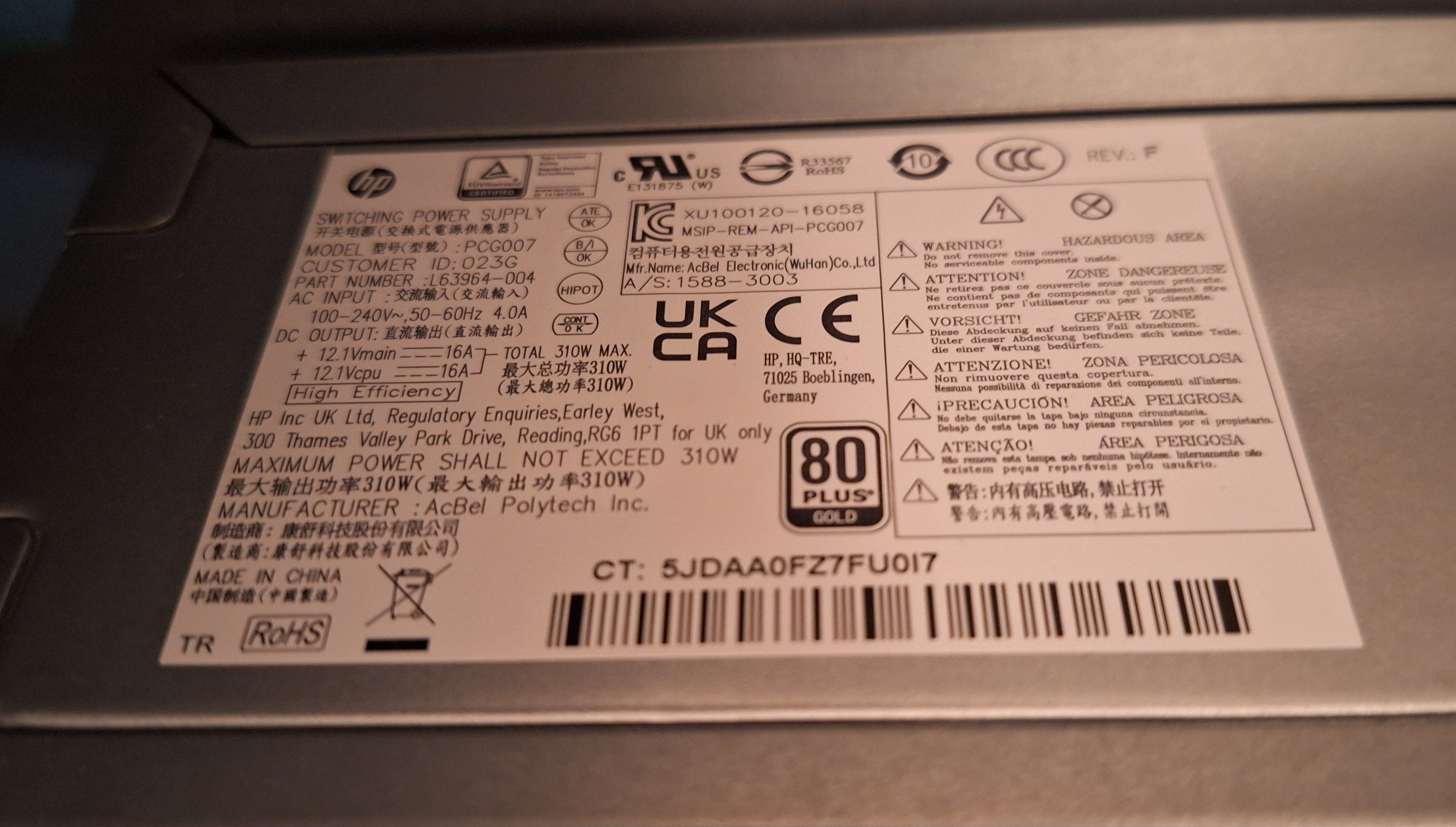

Does that psu even have 6+2 or 8 pin pci-e connectors? If it does I would be worried if it can actually deliver 310w on the 12v rail or is much of it on the minor rails?
Yep, it does come with a 6+2 PCI-E connector. I noticed then that HP did sell a similar 310-watt system with a 1660 Super last year, even though the minimum recommended PSU limit is 450 watts for the 1660 Super.

I just remembered to put a picture of my PSU:
