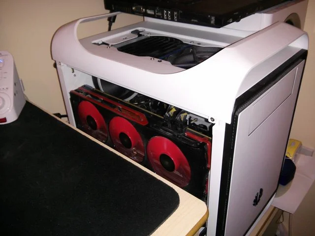

the case is pretty small when you have a monster like a 7990 in there

well i thought before i was gonna buy a new case etc, i'd at least give the rad a go and see what the temps are. it couldnt be as bad as it is now :( 95-98c on the 7990 and 85-90c on the 3770k (with the side off!)

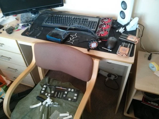

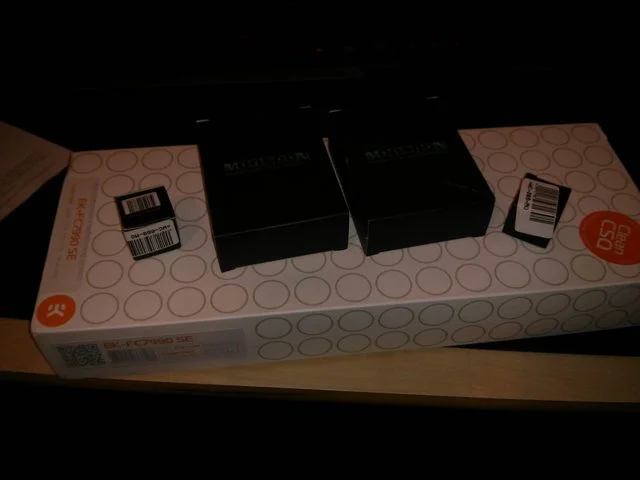

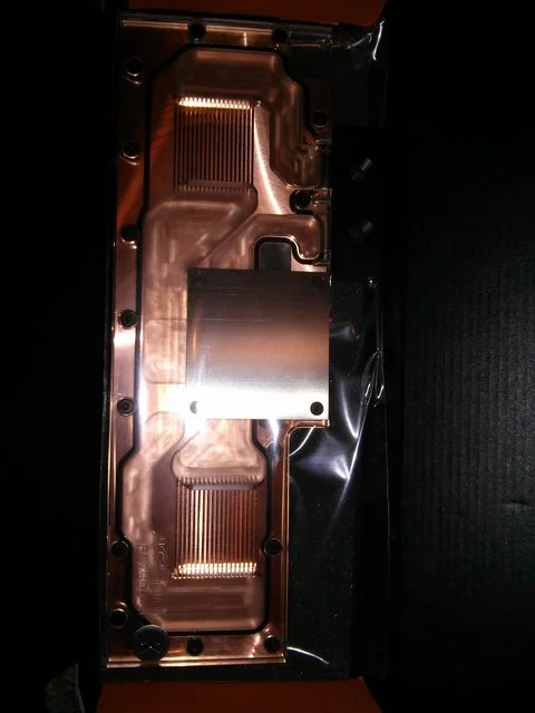

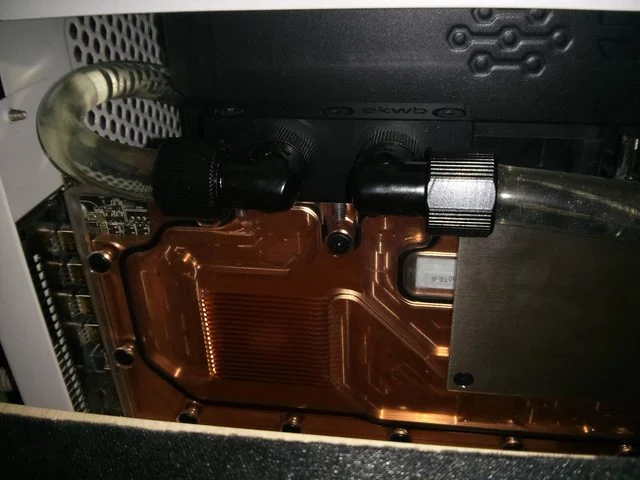

so, i think i prolly bought the last ek 7990 block, and i bought some monsoon fittings to try out,
new ek 7990 se block in all its shiny newness

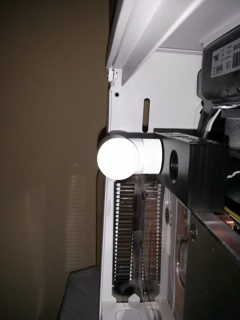

now the reason why i just bought these parts first was because the panel side of the prodigy is a bit cramped
i cant mount the fittings on the inside of the gpu block as it wont fit with the rad in.
i didnt know just how much space i had...
derp. double derp.
so back to hunting for fittings...
and i think i found the ideal fittings...
1 x Bitspower angle 1/4 inch to female 1/4 inch Deluxe White, 60 degree rotatable £13.94
1 x Bitspower Angle 1/4 inch to female 1/4 inch Deluxe White, 30 degree rotatable £10.99
2 x Bitspower angle 1/4 inch to female 1/4 inch - Deluxe White £7.99 (£15.98)
2 x Bitspower 1/4" Thread 7.5mm Extension Socket Deluxe White £4.49 (£8.98)
waiting for these to get delivered so i can test fit the gpu block again...

ah yea, the koolance rotaries are a good call.
i'll try the bitspower fittings first and see if they'll all fit together first since they're already on their way =x
the bitspower one isnt a rotary so its only 18mm diameter lets see if that works, if not, then i'll get the koolance rotaries
i dont mind even if the temps are ~60c with the watercooling tbh, as long as it is lower (and quieter). would it ruin the pump/other components if the coolant was above >50c?

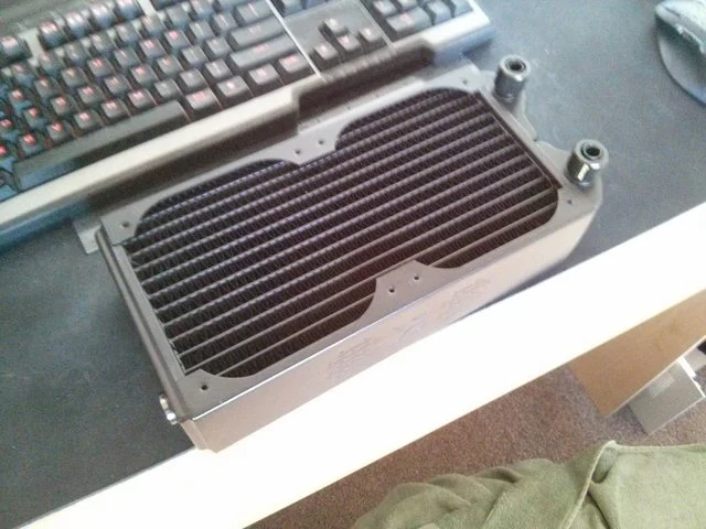

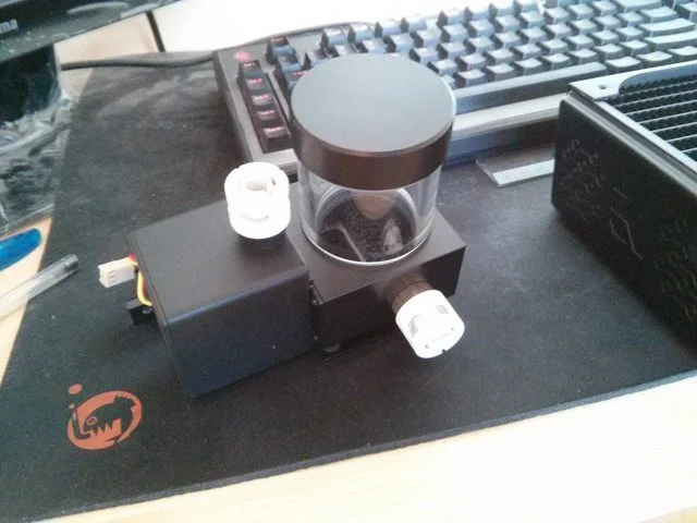

ok so after a long christmas/new year hiatus, the watercooling bug has bitten again...and thanks to the mining craze, i've managed to watercool for 200 quid, much less than i initially had set out to spend
had a few changes to spec along the way...
got the ek xtx 240 instead of the alphacool ut60
and the ek dcp 2.2 instead of the ddc due to size constraints

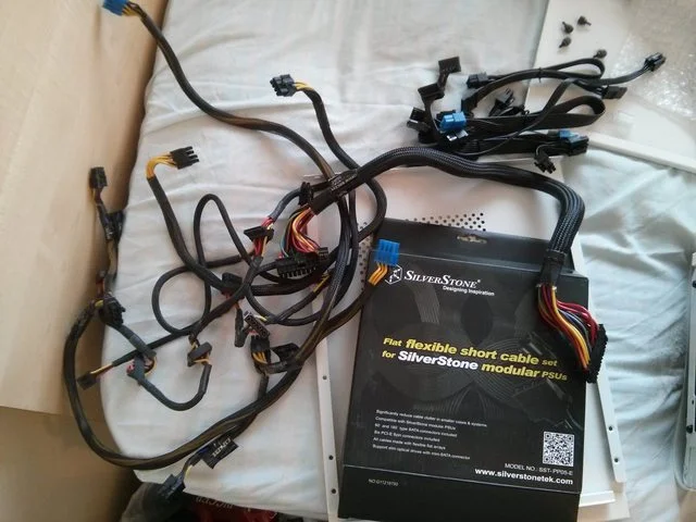

also decided to get a set of silverstone short cables. you can see the difference in size compared to the old cables, its really useful in an itx build with limited cable management
Man of Honour
OP
26 May 2012
16,564

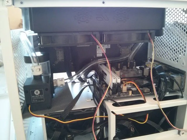

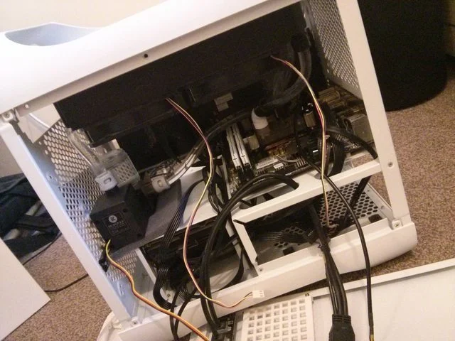

work in progress lol.
nearly complete! i took daveip's advise and went for the koolance fittings. worked a charm, but i had 2 monsoon fittings already so i saved the tenner and had mismatched fittings instead...but no probs, no side windows anyway =x

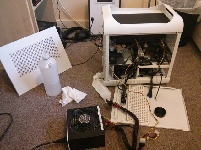

filling the loop time!
thank god no leaks initially...
gonna run it for another 24h before booting up the rig

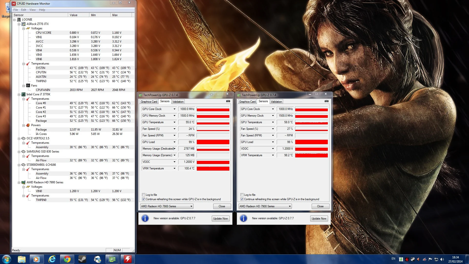

okay, so 24h of leak testing passed...
just did 2h of mining, so gpu only...results weren't too bad 55-58c on gpu cores, guessing water temps would be 45c (ish)
will play some games and see how it fares later
for now, a 40c drop in temps and the quietness is pretty impressive

Wow ... 7990 + cpu on a single 240mm. You got balls mate :p
I've got 2x240mm (albeit slims) on my 7990 (stock) and oc'd 4670K and I'm a little borderline comfortable at the coolant temps when it's going full whack.
Which rotary fittings are you using on the 7990 block? Can you close the side panel?

with a thick rad, there's 12-13cm of height space left for pump/res
that's why i opted for the dcp 2.2 as its small. im guessing if you mount the res separate to the pump you could fit a d5/ddc
and no, the 220mm fan, if its normal width, can still fit up front
