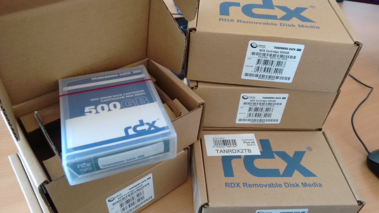

Drive and media arrived:
Backed up same files I would normally back up to Flash Drive:
2690 Dirs / 37723 Files - 52.703 GB Total - 18 Minutes 32 Seconds
48.5MB/s and that was via USB3.0, source drive was a standard 3TB SATA Drive.
