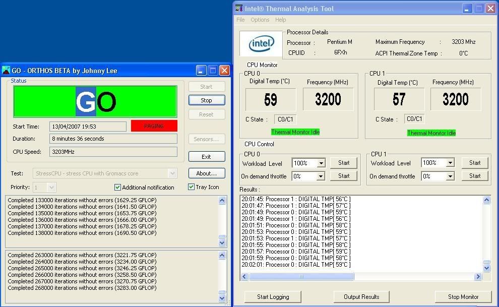

Here are the screenshots:
Ninja:
Amanda:
gt
BEn_2600+ said:
Set 100% load in TAT and your temps will go higher, did you lap the chip yourself or did you buy it lapped?
Bought it lapped from ted34 if you can find him to ask! I believe he sent it away to be done. It's a good job and is perfectly flat.
I know w3bbo did his to a very nice finish (pretty much a mirror) so it may be worth talking to him!
Funnily enough TAT @ 100% reset the pc with the voltage @ 1.48 :p
I'll give it a try now! :)

It might just be that the compound isnt as good as the ceramique but im using the thin line up the center of the core method and my temps are higher than I expected, but that could be to do with poor case airflow. With my case side off my CPU temps are about 6-7oC cooler. When i rebuild early next week i might try spreading the AS5 over the core as you mentioned:) Also did the 100% load in TAT crash your PC?
Ive also noticed your running Orthos on Priority 1 IIRC that wont stress your rig as much as 9 or 10, just a thought :)
No crash. Ran fine! Went to 57 degrees C though. Orthos at priority 9 got to 52 degrees C which i was happier about!

Got the 680i for £100 delivered which is ok! I'm running 1.42v now with temps not passing 51 in orthos and 58 in TAT @ 100%.
