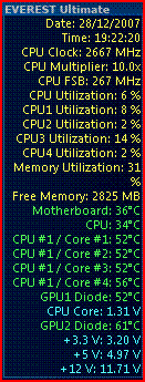

ok guys and girls
just installed my 2 dd 8800gts water blocks,think i have done it all ok.
this is all on 1 loop cpu and 2 gpu,so can any 1 tell me if my temps are ok or should they be lower.when i had just the cpu in loop it was about 48-50.
thanks
andy

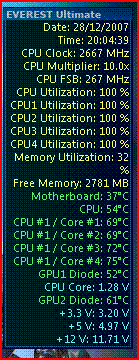

here are my load temps with prime.
Can you put some load on the CPU? Idle temps don't really mean all that much.

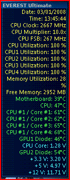

That's waaaaay to warm for a stock Q6700.
Which radiator are you using? You'll need something more meaty than you currently have for a pair of GPU's in the loop.

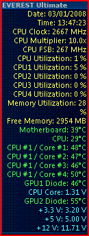

just put my new rad in pa120.3 and these are what temps i got now.
load
the thing is,will i see much of a drop in temps if i put in a pa120.2.as well
thanks again
andy
sorry about this bit.i got a dtek cpu block how tight does this need to be.at the moment it moves about quite easy is this normal,or is it to loose.
That's a decent drop, esp since your motherboard temp is higher.
