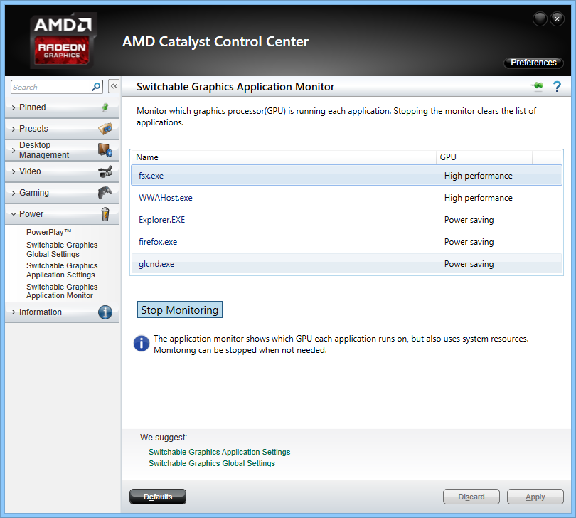

Radeon Settings > Preferences > Additional Settings > Switchable graphics application monitor.
Start monitoring, add the application to CCC Slim and set it to High Performance Mode.
cheers m8 works a treat now ta ;);););););)
