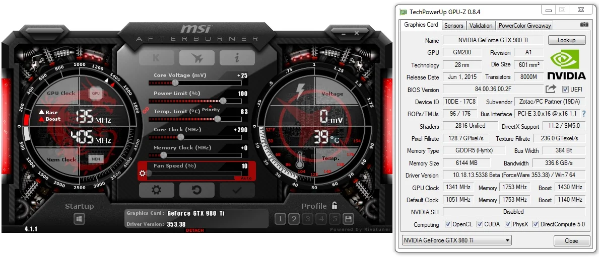

So I have been experimenting a little with the Zotac this morning.
I have run Heaven stable using the following...max temps 62C. Waiting for Corsair to start selling the HG10 N980 so I can slam my H75 cooler on this thing and see what it can actually do!
