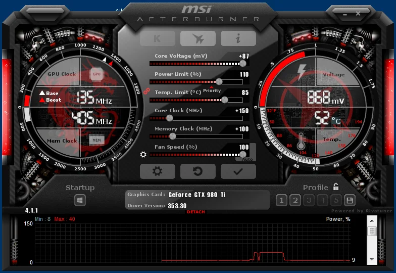

Any guides on overclocking this card and adjusting the core voltage?
Are these settings ok?
Gigabyte G1:
Dang is that some sort of custom skin? Looks different to my afterburner!
Nah it's one in the options called "MSI cyborg skin red"
