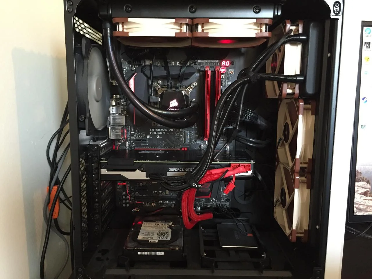

Well I got my EVGA 980ti Hybrid set up and it's running like a dream. I have a stable overclock boost to 1450 and it's whisper quiet and never gets hotter than 45 degrees even at peak gaming. Delighted with my purchase and the 5 year warranty, it oozes quality.
Benchmarks scores are a huge increase from what I was getting on my 780ti at 8500 in Firestrike Extreme (vs. 5400 on my 780ti OC). I think I'm held back slightly due to the ASIC quality on my card only being 65.8 but I'm delighted with those results and can see a huge difference in my games...plus my PC doesn't sound like a lawnmower any more when I used to stress out my 780ti Gigabyte windforce...that card was LOUD!
Now there is one piece where I need some help...
I recently bought some NF-S12A 120 mm fans. I'm pleased to say that while all 6 work, there is one fan that doesn't work when I fit it to my EVGA 980ti Hybrid all in one cooler.
This fan is replacing the stock fan that came with the All In One Cooler and uses a 2 pin header from the EVGA Card. I've tried swapping out fans from different brands as well as different noctua fans but for some reason, the Noctua fans are the only ones that don't work. The original fan that came with hybrid works just fine...
Is there a special requirement or restriction on the NF-S12A that prevents it from working with a 2 pin fan header?
I look forward to your advice as my preference would be to have all of my fans as noctua fans rather than have an odd one out by putting back the original stock fan.
Thanks,
Joe_Easy
2 pin is just missing the rpm signal wire.i would try plugging it onto motherboard header and using it that way.you could control the fan via bios.

Zia - That was genius and worked perfectly. In hindsight...should have tried that to begin with as it's an obvious fix and actually a better outcome as I now have full fan control from the MB, which you don't have from the AIO card itself.
Thanks for the help! One of the reasons I love this community.
Card is even cooler now, going to try another benchmark run and see if I can squeeze any more Mhz out of the card...

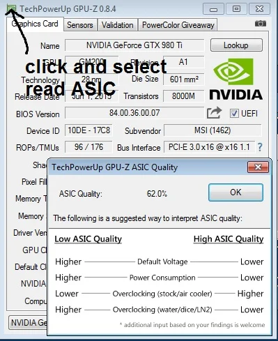

55is probably about as low as they go before they start binning cards, most peoples seem to be around 68-80

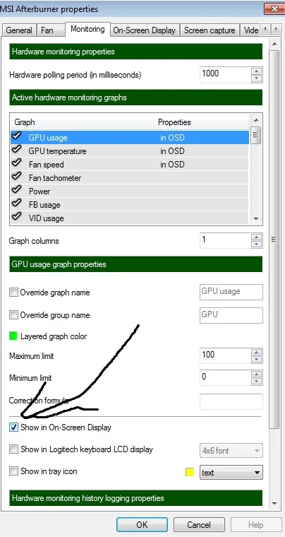

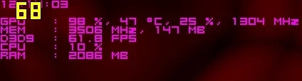

you can monitor your card in game via afterburner to see what it's doing
just select the setting above and tick the box I arrowed for each one you want visible in the corner

So I got the noctua fans working (thanks again for the tip Zia) on the AIO cooler and my new EVGA Hybrid is installed and working very well.
