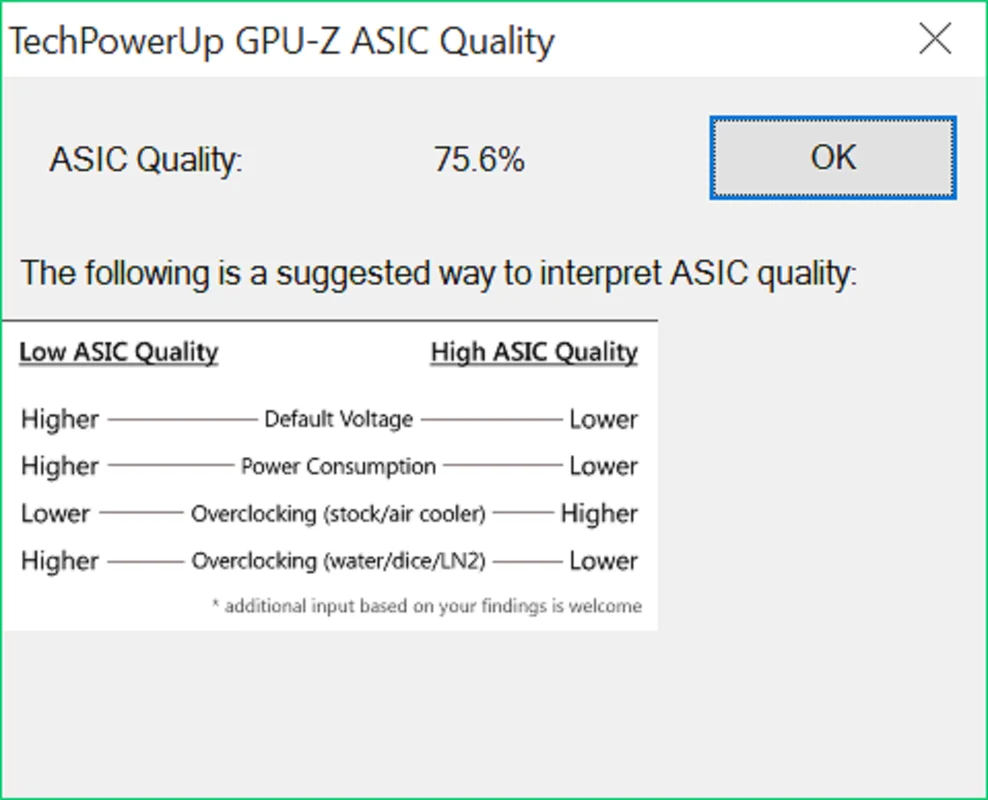

ASIC quality is 69.7% for those interested, max voltage on core 1.155V.
