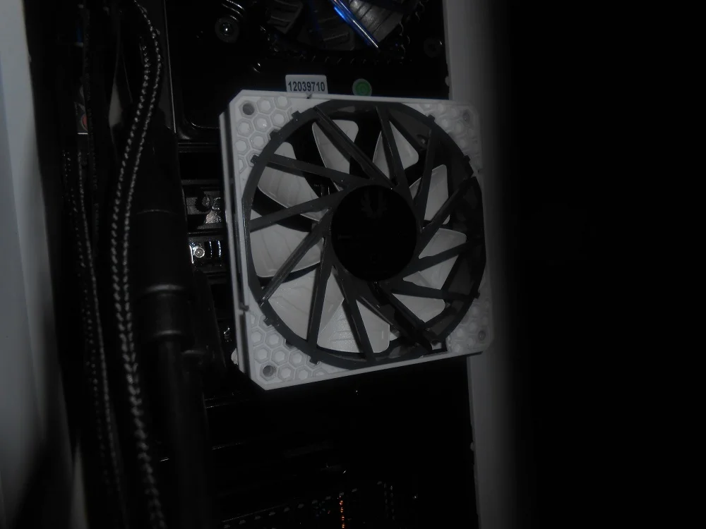

Sometimes you have to think outside the box, or case in this instance. Ghetto mod time, probably won't help but worth a try. :D
What did you stick the fan on with Matt? I used stuff similar to blu tack but after a week or so the fan fell off.

You know me too well. Temps eventually peaked as they did before but got there marginally slower. Not enough difference to keep it imo. Looks like the spot fan is the next best solution.

I'm assuming your PSU is based to intake from below here, so:
Place a fan just over he PSU, "Under" the cards. It will not draw air from anywhere outside, but it might push the warm air on that pocket all the way up to the back exhaust. Of course it needs to be a few millimeters higher than the PSU, but just put big blu-tac blobs on the corners or something.

Now that is a good idea, thanks man will try it now lol.
I found a 1400 rpm 140mm fan worked much better than a 1500 rpm 120. The frame of the 120 blocked the card vents a bit.
Only a 120mm will fit sadly, case is not big enough too cramped.
Makes suggestion appears to have knocked 2c off the top gpu, but i need to play a longer round to test.

Ok the Make Mod was 1c worse on temps so my original setup is still the best so far. Quite happy with it tbh as it sits happily at 90c and does not budge. Out of ideas now so will wait for the spot fan and fiddle again.
