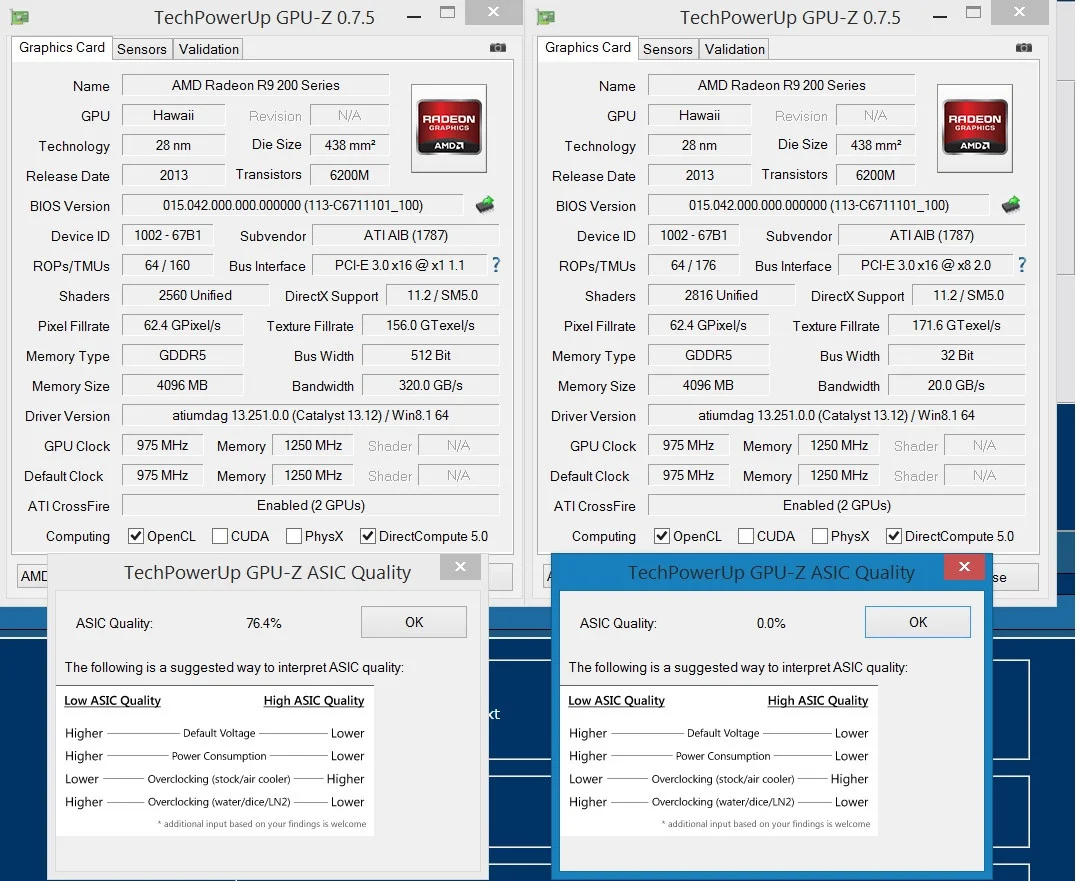

That a Nice memory Bus Width & Bandwidth you have on the second one there..:p
ULPS turns the second card off so hence the low bandwidth.
