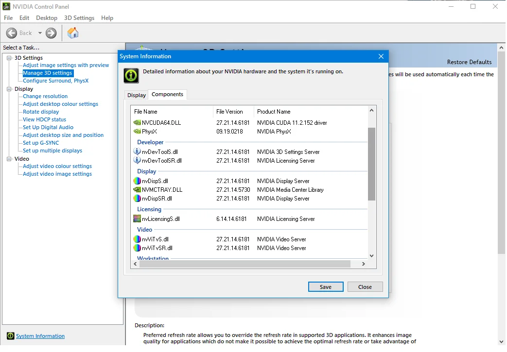

See in this screenshot I have 457.30 of nvmctray.dll (457.30 came from windows update on first boot of windows).

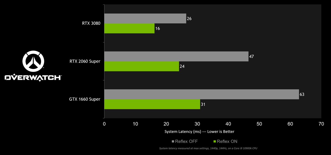

If you were not so paranoid and just installed the driver you would see Reflex mentioned in GFE for Overwatch Test Region < not my type of game.
I cannot copy/paste the text from GFE.
