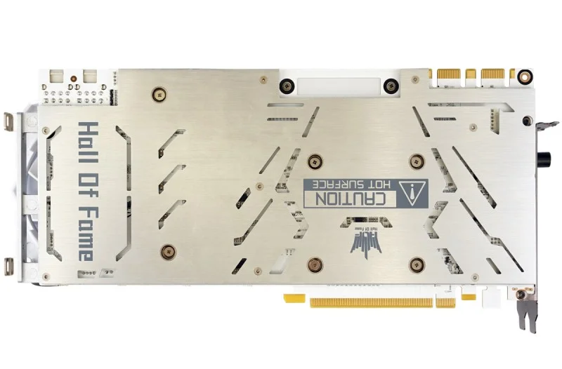

Can you take a picture of it inside the case? The 980Ti had the tackiest writing on it.
Not mine, just fixed the image link for him.
That's the back though if that's what you meant.
