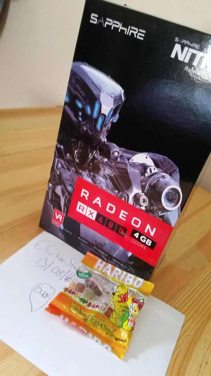

Welcome and TROH updated.:)
The Roll of Honour.
Date 13/08/2016, Make Sapphire Nitro+ OC 4gb, EGuitarStar, Link

To get on the Roll of Honour all you have to do is post a pic with your user name on it of your RX 480.​
