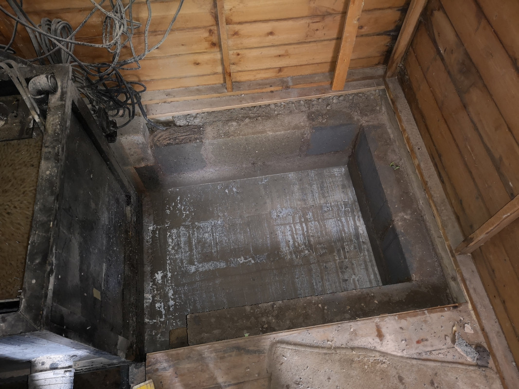

Majority of the soil now dug out and putting in the retaining blockwork as I go along to support the filter house above it.
Am toying with an idea to extend this filter bay upwards above the waterline, then use a skimmer in 1 end and effectively "overflow" the tank to return. That way I can make use of the vertical space to increase bio capacity.

1) Relocated the sump pump pipe to make room.
2) Got supports in for filter house corner.
3) Dug out the corner, got the concrete blocks around.
4) Backfilled the blocks
5) Put in new corner support for filter house.
6) Backfilled second layer up to the corner.
Tomorrows job will involve the final bit of digging out the final side, getting the first layer down and backfilled, finishing the second layer on the bits that are going in tonight and backfilled.
All going well by middle of the week I can get the concrete base poured in, debating if I should drill into the existing base and rebar it across both or not (even if its just some 10mm) or if im just wasting my time given its only going to be supporting a ton or two of water at most.

Rebar was drilled and chemically bonded into the existing concrete slab 2 days ago.
Nice and cool morning today so mixed the concrete and bonding agents and got the new base down.

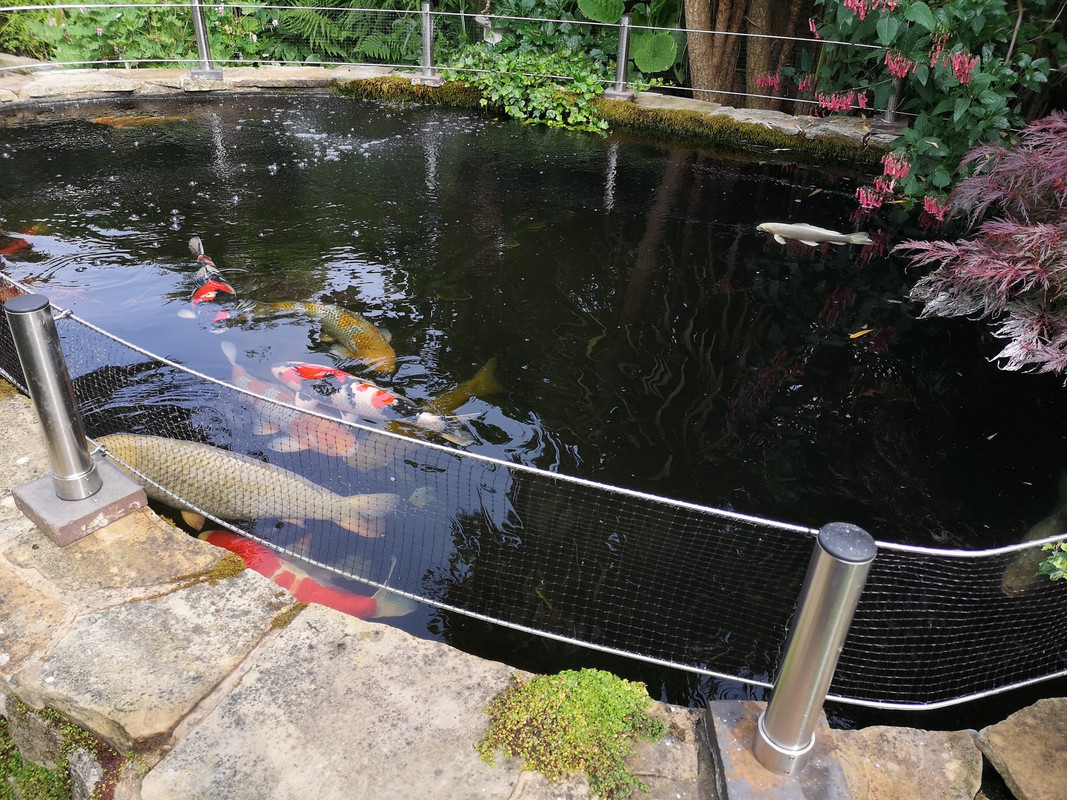

Dont try and overthink it, fish jump, its just one of those annoying facts of being an owner, I finished up my jump guards a few weeks ago, made difficult from the shape/form of the pond, used some reclaimed tile in the end as nothing would bond to the old stone which was also too brittle to drill. By the time its weathered in should blend ok.
