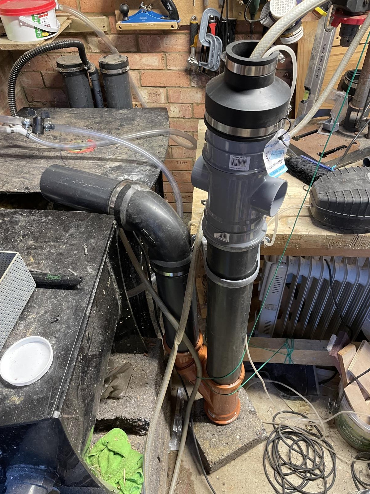

Pulled some blanketweed, added some blanket answer, and tested out my new protein skimmer temporarily to check it would work. I think it will but it needs some adjustment.

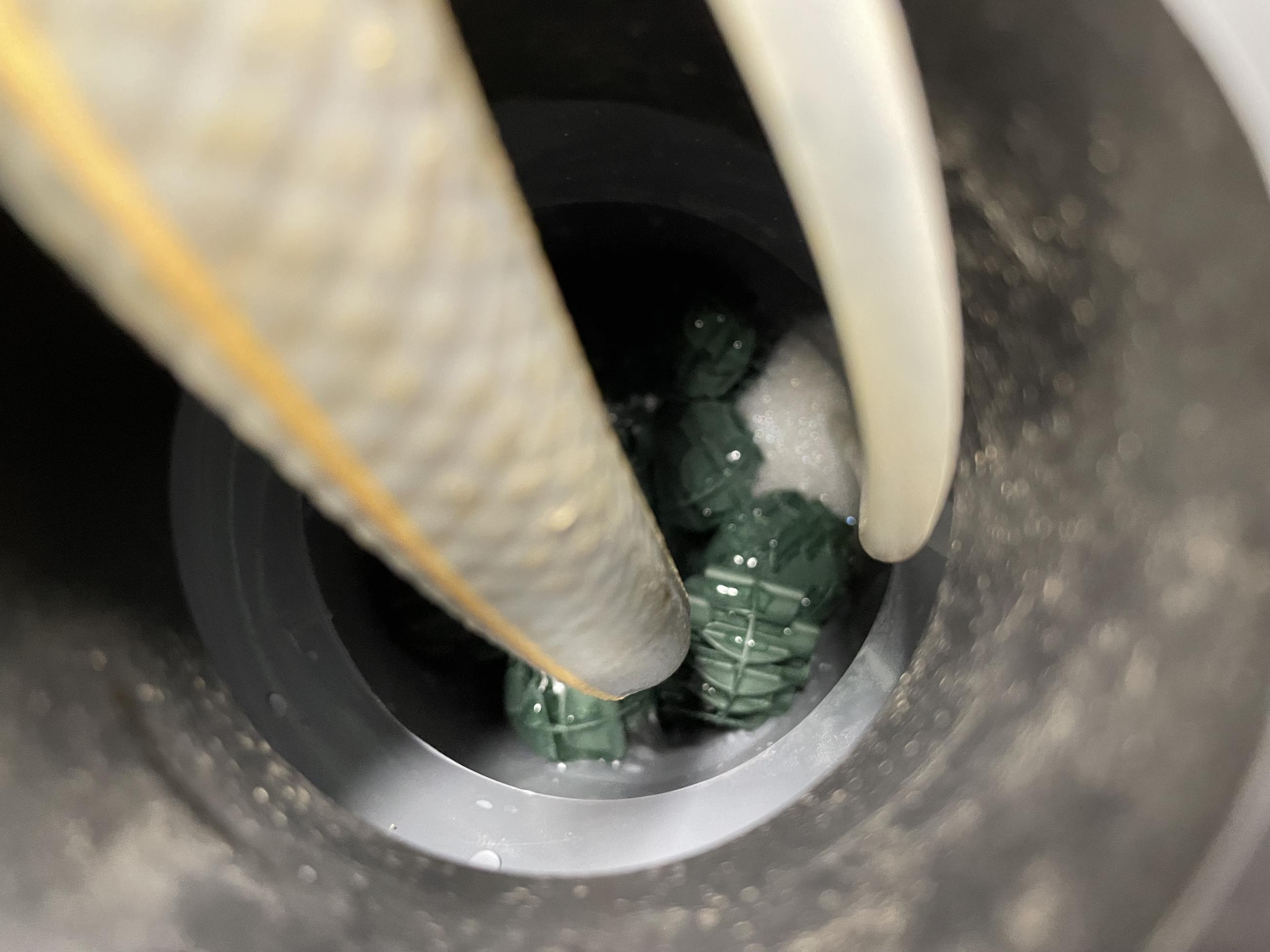

Modified the skimmer, and tried it in the afternoon:
It's a simple reverse flow style where water comes in the top, it drops down through media, then exits at the bottom. The spout then maintains a water level in the main body that results in the airstone bubbling up. So the airstone causes the frothing, the media allows for more contact time down the body. There's a plastic spider in the tube that stops the media from sitting in the base joint and keeps the airstone raised off the top - it's located just above the brown plastic - main body connection. This also attempts to prevent the foam from going up the spout.
I may tune the level of media at the top so that the foam isn't broken up on the media above the water level. What seems to be good is that the foam is small bubbles and quite damp so it should rise up more.
You can see the foam appearing:
This morning the airlifts had clouds on them (big foam!), so this project is becoming pressing.
I will do some adjustments to make a foam trap so the foam can overflow into a container. This essentially removes the DOCs (which case the foam) from the pond.
When I'm happy this works I can simply plumb this is in - possibly using a T in to the return down pipe for the spout return.
