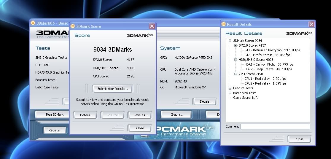

All I have had time to to this evening is one 3D06 benchy and I got this.
I don't think its that bad tbh.
I'll post more tomorrow - Let me know what you want this card to do, apart from clocking, and i'll try and get it done for you.

I thought you were getting over 10k with your new card m8? Was that overclocked at all?
Gotta say im really tempted to ditch my 6800GT's and just get a one card solution. :rolleyes:
Hi Scoob,
I haven't broken the 10K barrier yet 'cos I haven't started to clock the card yet. I think the ambient temp is way too high. I'm wondering what WC blocks I can get for it.
Agent.
