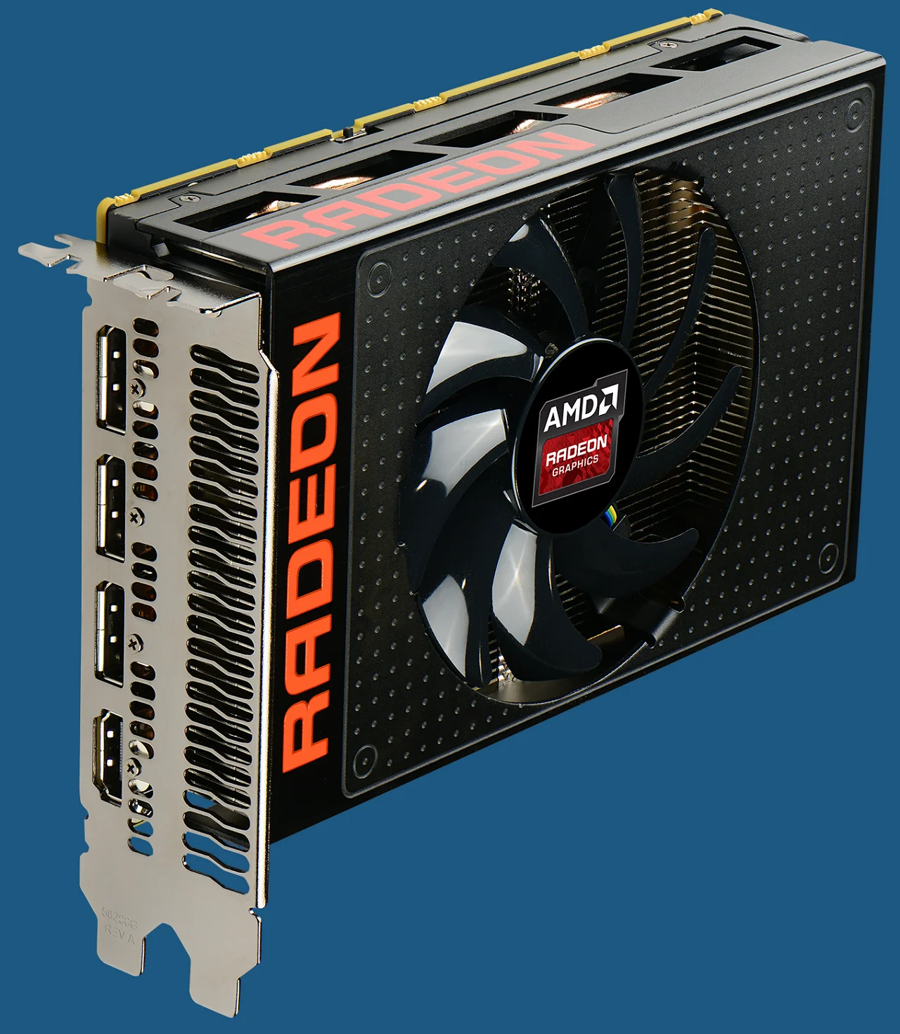

Mornin
Guys i am seeing the card climb to 84c
Any idea whats the throttle cutoff on these?
Tried playing around with fans and its not it

The card will throttle well before hitting 83 degrees, it starts to dynamically reduce core clock when in the high 60's from what I recall when mine was under air increases as temp rises. I normally topped out at around 76 - 78 degrees with the stock fan profile by which point the card had reduced the core clock to around the high 8xx Mhz which seems to tally with what other users are seeing: http://www.guru3d.com/articles_pages/amd_radeon_r9_nano_review,13.html
I would probably check the temps and see what the core clock is reporting back, if its reducing core clock behaviour that would be normal. Does it also go to those temps with the fans ramped up very high?
Managed to get it to 72c with side open and hairdryer blowin cold air. Didnt see much throttling. Will setup 2 profiles, Gaming and general. So far the only solution. with fan speed at 60% temps went to 75
Re-arranged the fans a little, fan speed on 60%
Unigine Valley test went well, no drops, 70c max
BF4 might go to 75 if that, which is still very good
Hope this might be of use to someone :)
