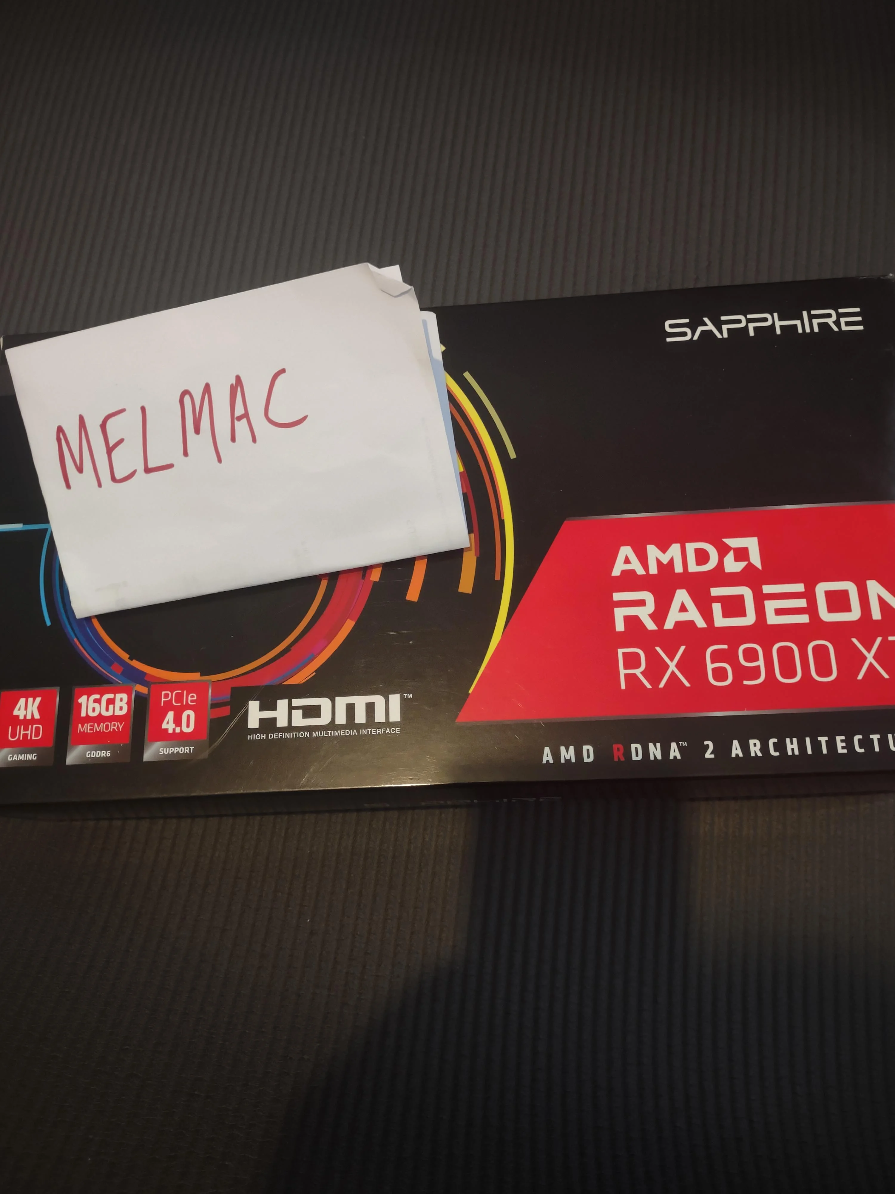

Please add me to the owners list when you get a chance. Thanks Kaap.
It's been an interesting few days getting used to my new card. It's a powerhouse in normal gaming, no issues there at all. However, in VR with the Quest 2, it's not as good as the 2070 Super it has replaced, I am hoping that a CPU upgrade will improve things there. Haven't tried any Ray Tracing games yet.
Welcome and on TROH.:)

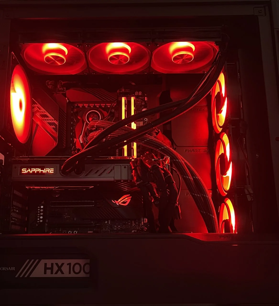

Here's a pic of it installed,
Far from the prettiest setup but I need to sort a new case today too.
In regards to overclocking, I'm getting something wrong somewhere as my scores on timespy aren't improving, just getting lower.
As a starting point, performance bios is selected, I've gone into the Radeon software and tuning control, manual tuning, fast memory timings, power limit 15%, I've enabled trixx toxic mode which boosts my max frequency clocks to 2660, voltage is at 1175mv.
I also tried following your MPT settings, 450w, 425tdc and 60soc, hit write, restart system, but my scores just don't improve, I've noticed in the Radeon software my powerlimit is back to 0%.
I'm sure I'm just missing something, should I be using wattman alongside mpt? It's all new to me coming from team Green but I'm keen to see what the card can do.

Ooh, I thought you were getting a Toxic Extreme Edition, not the Limited Edition.
The Limited Edition has a lower clock speed due to the die not being binned like the Extreme Edition, less available voltage for overclocking and lower power limits.
Not to worry though, we can adjust the latter with MPT. It sounds to me like you are power limited and that's why your score is not going up.
Follow my guide here and see if it helps with a higher score.
Think I've managed to sort the issue, using MPT I wasn't aware that I had to select my card from the drop down list, so hitting write wasn't doing anything.
Working now, hitting a wall though at about 2720 core 2100 memory.
