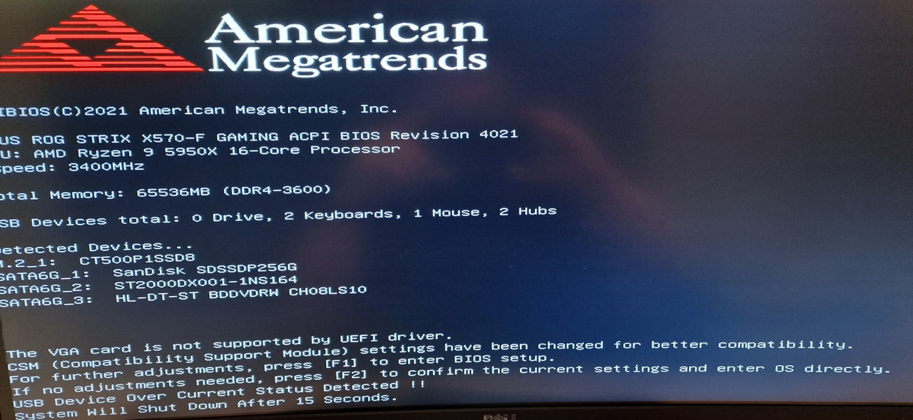

Just walking past the office and heard the fans going mad on the 6900XT. Couldn't get tye screen to resume, so tried remote desktop from my phone to access the PC and there had been a driver crash so rebooted the computer from RD. Now it won't boot into Windows. Instead it gets stuck just after the Bios screen with the following error.
Keyboard can't get me into the bios at this point and it just shuts down.
Any ideas?

@Biffa - Try clearing CMOS and clearing power to the system for a minute.
Keyboard lights are all good during boot. Caps lock light etc
@LtMatt have left powered off overnight, next step, open her up and clear cmos then try another keyboard, swap out gpu etc
Just wondered if anyone had experienced anything similar before, must admit it's a first for me.
Yeah and nothing had changed hardware, driver or Bios wise before it happened. :confused:

Did the trick, got back into Windows, but couldnt load radeon software as device was disabled in device manager. Re-enable, rebooted and all working again.
Wierd.
Nice one. :)
