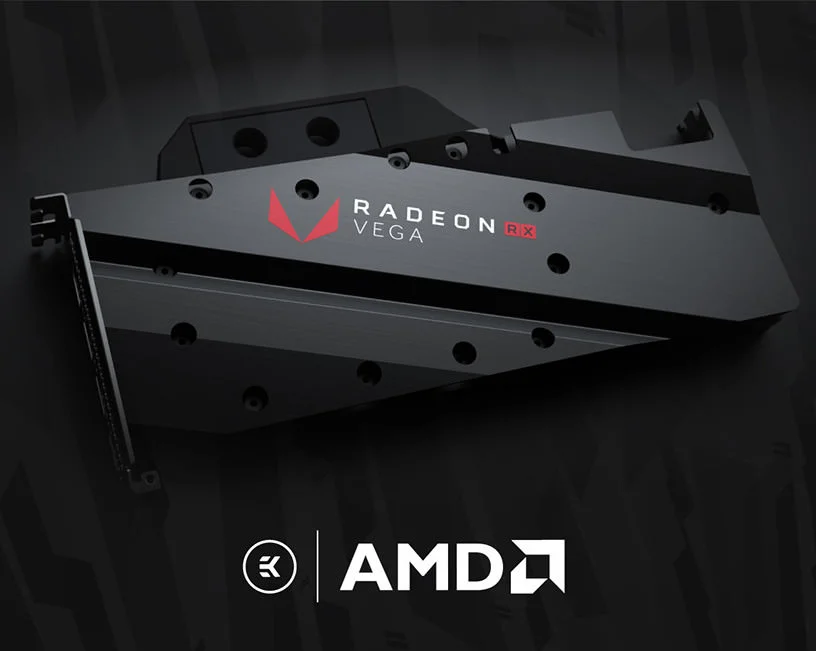

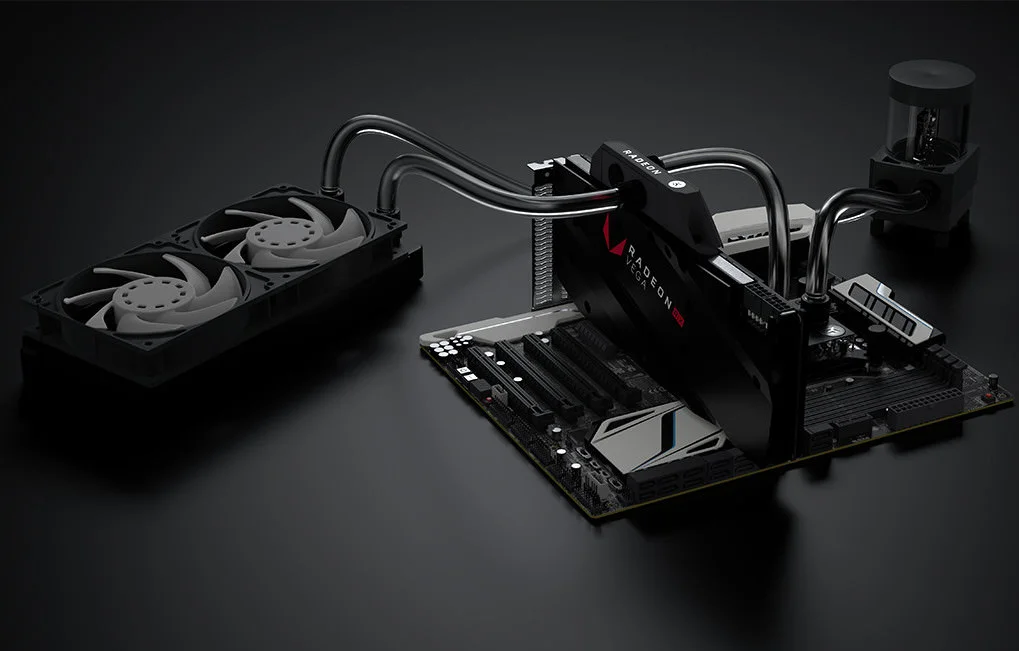

EKWB releases their new Fluid Gaming A240R kit and RX Vega water block
That looks sex! :D
