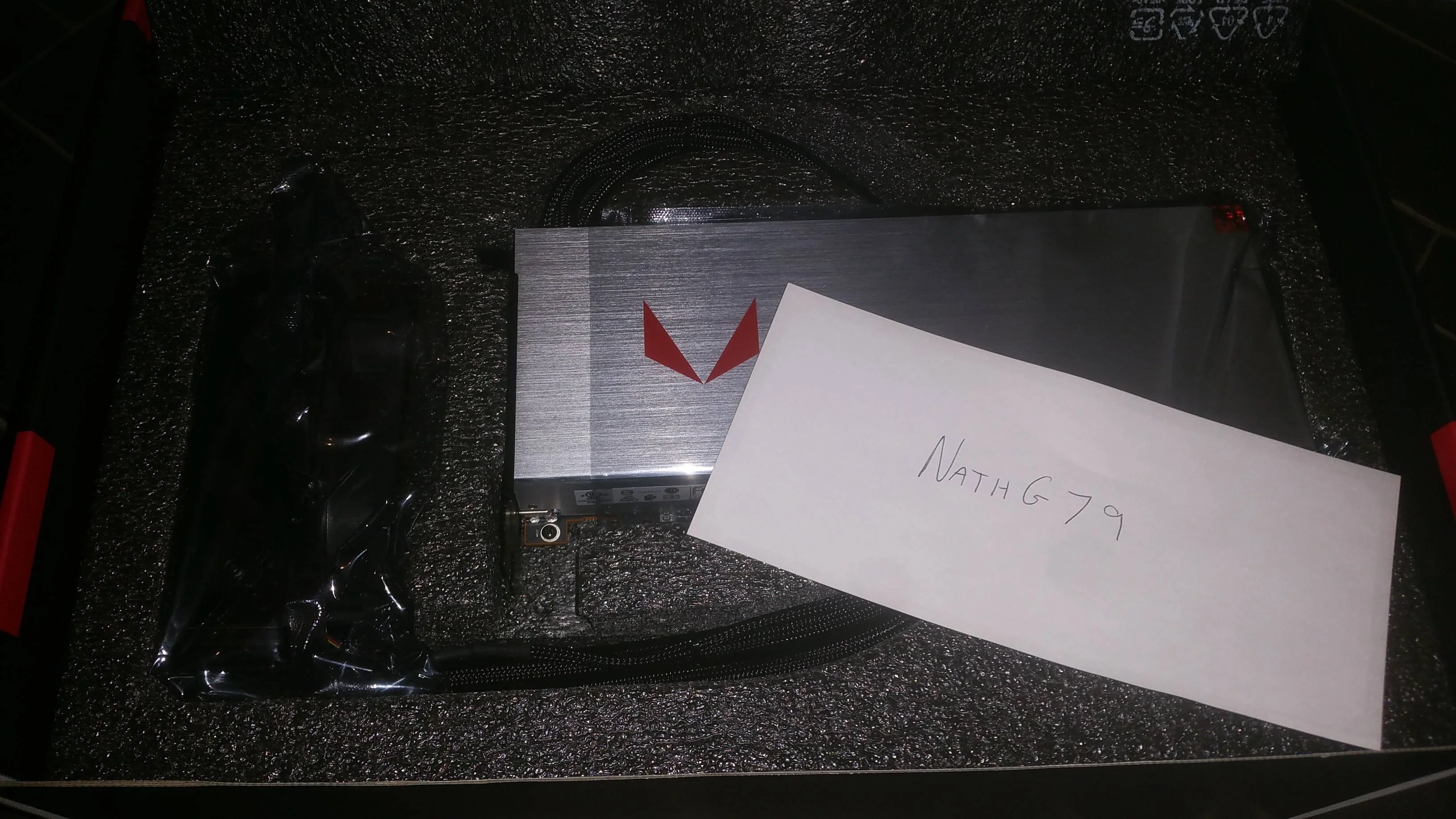

My Msi Vega 64 'Wave' AIO arrived yesterday.
I don't ..... Think so .... (I'm 95% mine didn't) but now I'll have to check tomorrow :D
AIO had it round the radiator and a plastic protector on the open side (the other has the fan pre-mounted) - nothing on the card other than the anti-static bag - not even a pci-e connector protector.
https://ibb.co/c6vDSF
Sweet :D .
Any chance you can supply copy of both switch position VBIOS? grab AtiWinFlash v2.77 from this thread.
A member on OCN supplied incomplete copy, please make sure it's 256KB, cheers. A member who shared RX VEGA 64 AIR we have noted bios switch towards Display IO is higher PL and towards PCI-E is lower PL, VEGA FE also is this way, I would assume it is also the same for other VEGA cards.
