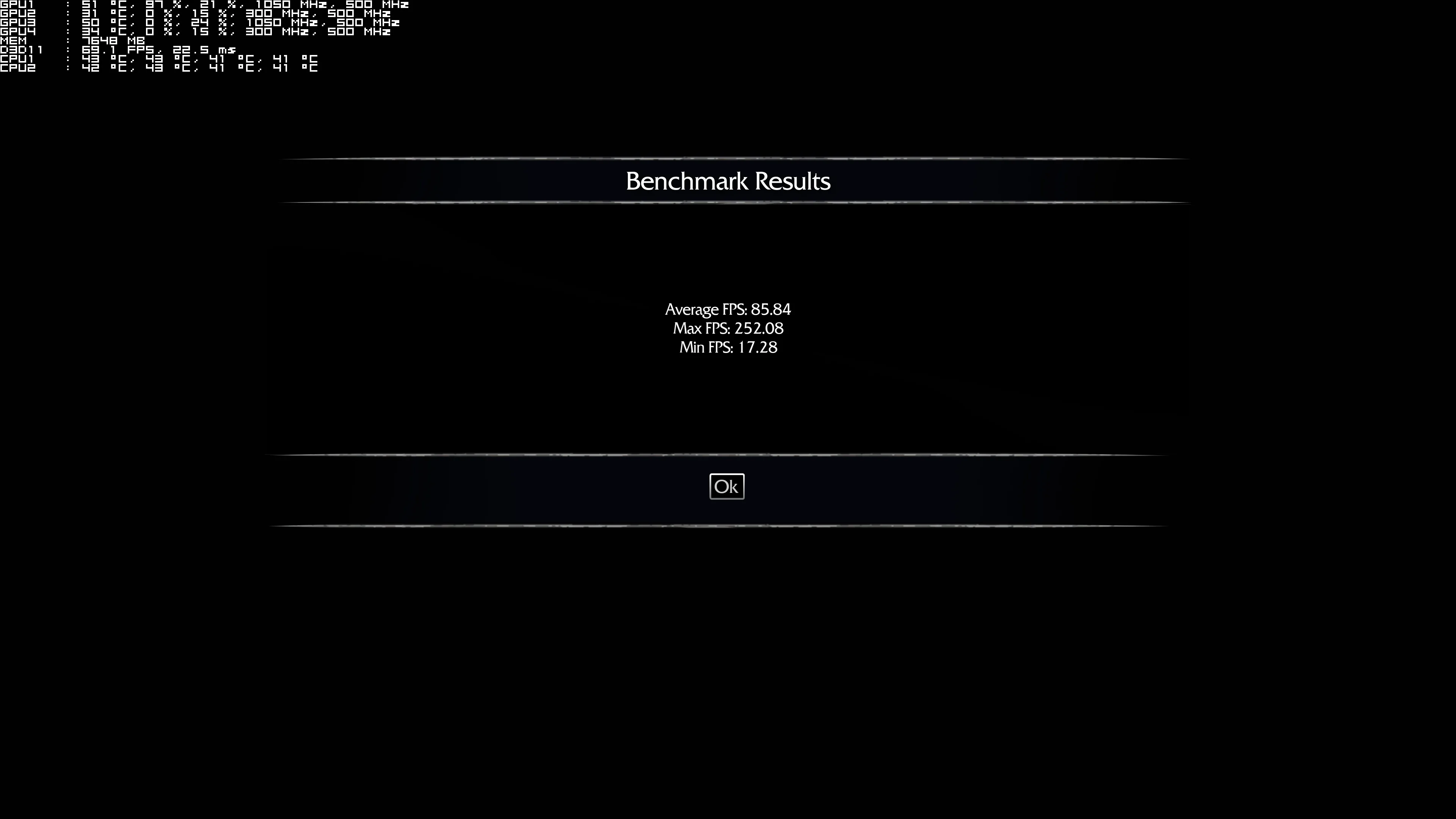

The Shadow of Mordor Bench.
Perfect scaling would be double your single cards fps not over 3x the fps. Dodgy.
But you have gone from 39 fps to 139 fps. Sorry but that isn't perfect scaling, that is questionable scaling to me, as that is effectively running the same as 3.5 Fury Xs but only using 2 cards. Something definitely up with that.
Anyways, not my shout and Kaap can decide what to do but something is wrong there as perfect scaling would be 78 fps.
I just ran it again using the default AMD SOM profile and got 85FPS, this was with my cpu at stock and a warm run. No clue why to be honest and Kaap can test this himself using the cards to verify what I'm saying is true.

I posted my results and was honest about the method used and i spoke with Kaap about these results prior to posting. That said, I'm happy to use the default profile only but i thought I'd post them anyway as they're interesting. With even the stock profile offering over 100% scaling though I'm not sure i can win either way, shrug.
All good Matt and like I said, it is Kaap's call if he allows it (and seems he will as you spoke with him). I just find it odd that 2 GPU's that you say are perfect scaling are actually scaling like 3.5 GPUs using driver tweaks.
I don't know if he will, but he knew that AFR Friendly gave a big boost over the default profile. I'm happy to only use the stock profile of course so can re-run no problem, but the scaling is still over 100% with two gpu's on the stock profile so not sure what can be done. Once i ramp up the cpu and do a cold runm, that scaling is going to shoot higher as well. Are we now going to disallow that as well because it's over 100% scaling? It's a tricky one. AFR Friendly is a very common method used in multi gpu. As to why there is such a big increase though when using this particular method in this game, I've no idea.

What can you do though if CrossFire scaling is over 100% using the stock CrossFire profile/settings?
I also wouldn't consider using a different CrossFire profile as cheating, as it's just using a different method of multi gpu, ie AFR Friendly, 1x1 Optimize, or a custom profile from AMD using one of the above plus additional optimisations.

Just seems odd that no other test site has scaling over 100%, even with the default profile and not using driver tweaks.
http://www.pcworld.com/article/2947...n-fury-crossfire-review-2-fast-2-furious.html
http://www.gamersnexus.net/hwreviews/2008-amd-radeon-r9-fury-x-full-analysis-and-crossfire/Page-3
Something is deffo up for it to scale past 100% even on the default profile before you started using driver tweaks.
Anyways, it is just a bit of fun, so no worries and crack on :)
There are no driver tweaks, I'm not sure why it's scaling past 100%. I just ran it again to make sure and scored 84.5 FPS so not sure to be honest.

Anyways, here is my score for the thread with no driver tweaks and everything as it should be.
GPU Titan X @ 1409/4002 - 3930K @ 4.4 - 353.38 drivers - 3840x2160
