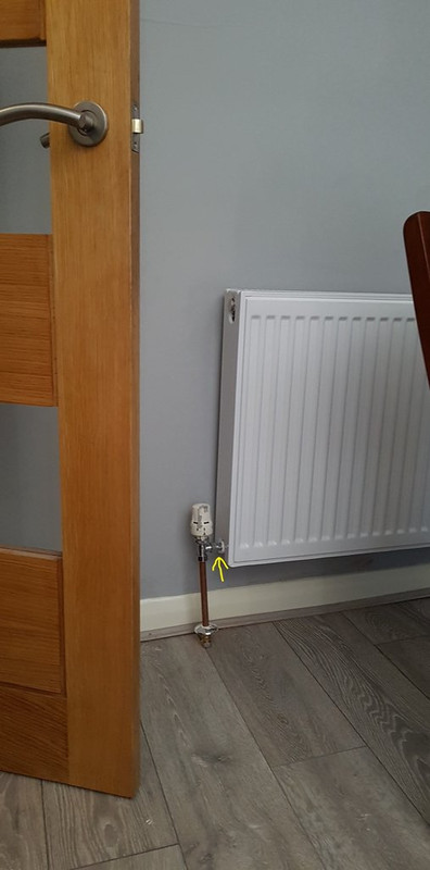

While he was here he went into my front room to check the radiator and we had a catastrophe, the valve broke away from the radiator followed by flooding from the radiator and water peeing out of a crack in the upright copper connecting pipe that the valve sits on.
I didn't really understand what he had done to provoke that ... but never mind ... he over torqued something ? - but he has professional insurance ?

He went to check the radiator, I didn't see what he did and he told me the bit I've arrowed in yellow just broke away. And the vertical copper pipe coming up from the floor had some cracks in it. So no idea, but it was obviously weak and had he not done that, who knows if it would have just come away at some point and I'd have been struggling to stop water coming out. I'm not going to bother with buying detection equipment myself, this is too major for me, I need professionals in. I'm wondering if it's worth calling british gas to investigate or call the original gas engineer that installed my central heating? Seems like thermal imaging detection is the way to do it. Apparently it's about £400 to buy one, so maybe there's a thermal leak detection company that I could get in to investigate it.

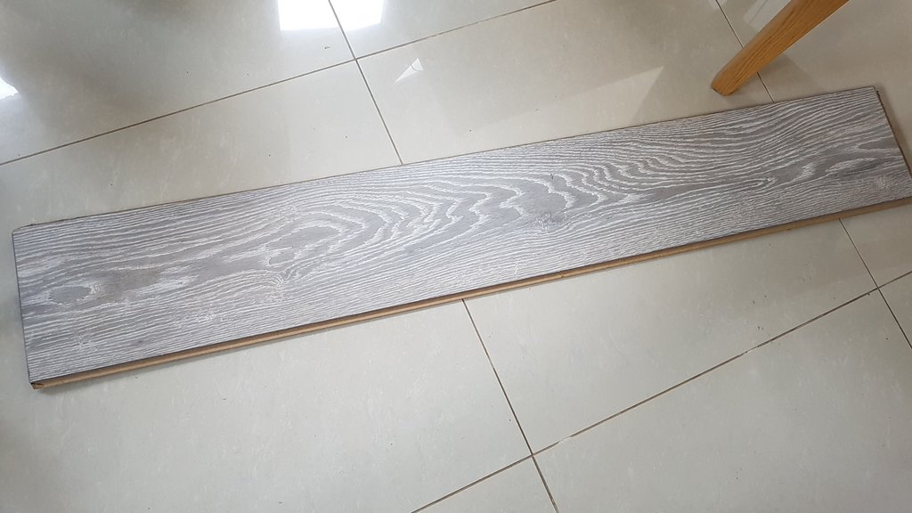

Well it looks like Howdens still sell the same laminate flooring I've had for 8 years so at least it can replaced. https://www.howdens.com/joinery/flo...-grey-oak-laminate-flooring-222m-pack-sdh3578
Looks the same as mine anyway. This is a spare board I have. And if the porcelain tiles have to come up, I hope B&Q still sell the same.
