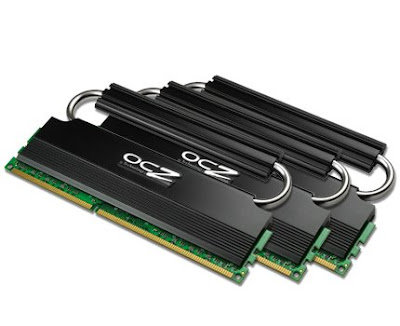

The case is more than wide enough to accommodate the Silver Arrow. My own LL is the same width and the SA was totally fine in that. The OCZ Gold will also work perfectly as they use low profile heatspreaders. Again, I have the OCZ Platinums which are exactly the same in design bar the colour and had no issues.
